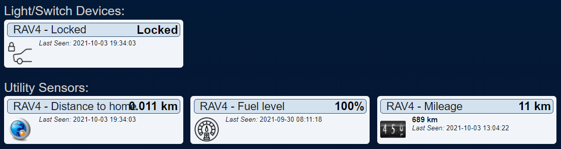

I have created a Python plugin that is able to retrieve the information from a Toyota car, when it is using the Toyota Connected Services. It is using the same API that is used by the Toyota MyT connected services app. This API is however only useable for cars that are purchased in Europe. For more information on Toyota MyT see: https://www.toyota-europe.com/service-a ... toyota/myt
The Toyota car should first be made available in the MyT connected services app, after which the Toyota plugin can retrieve the information, which is then provided as several devices in Domoticz.
At this moment the following devices will be available in Domoticz:
  • Mileage - Shows the daily and total mileage
  • Fuel level - Shows actual fuel level percentage
  • Distance to home - Shows the distance between the car and home
  • Locked - Shows the locked / unlocked state of the car
The devices that are provided by the Toyota plugin
