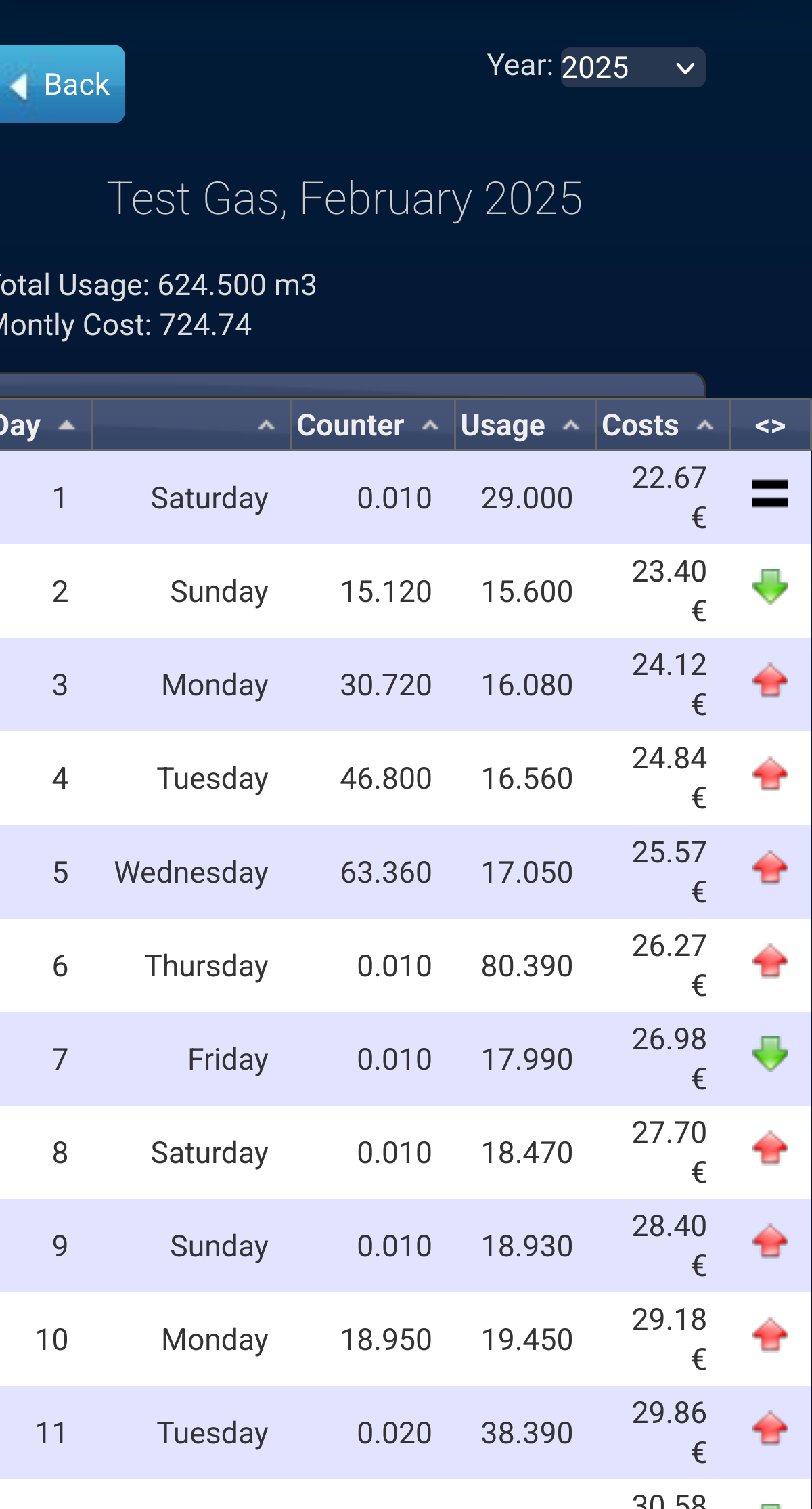

Below a screenshot of my test environment where I apearantly fill the counter incorrectly with a script and sometimes counter and usage does not match. So cost calculation is incorrect (1 m3 = €1,5)
