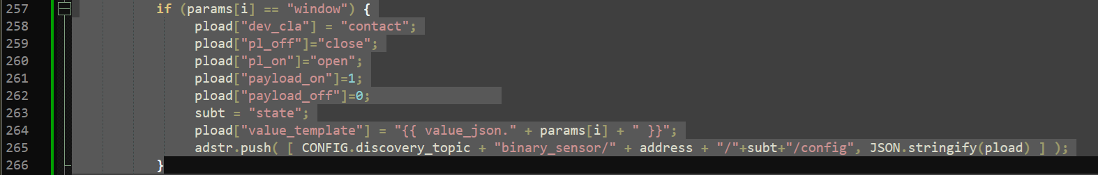

Hello everybody, I would like to share an original shelly script modified to add window/door contact sensor (and illuminance + rotation) to domoticz via MQTT autodiscovery, the device is this one Shelly BLU Door Window
https://www.shelly.com/fr/products/shel ... ndow-white
copy paste the script in attachement in the shelly device (and activate bluetooh), this is working only for PLUS series
the script is based on this shelly script ble-pasv-mqtt-gw.js dowloaded directy from the shelly script library and I add this 2 modifications
modif Z-2.png (49.18 KiB) Viewed 1141 times
modif 1-2.png (19.2 KiB) Viewed 1141 times
so if you copy paste the script in attchement, save and start it the device should appear in the domoticz devices list

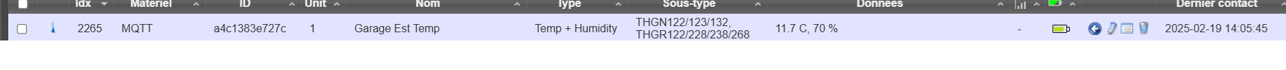

note this script is working also to add temperature/humidy from LYWSD03MMC also via MQTT autodiscovery (xiaomi sensor flashed with this way
https://pvvx.github.io/ATC_MiThermomete ... asher.html)
MQTT temp.png (23.15 KiB) Viewed 1136 times
I hope it could help someone
