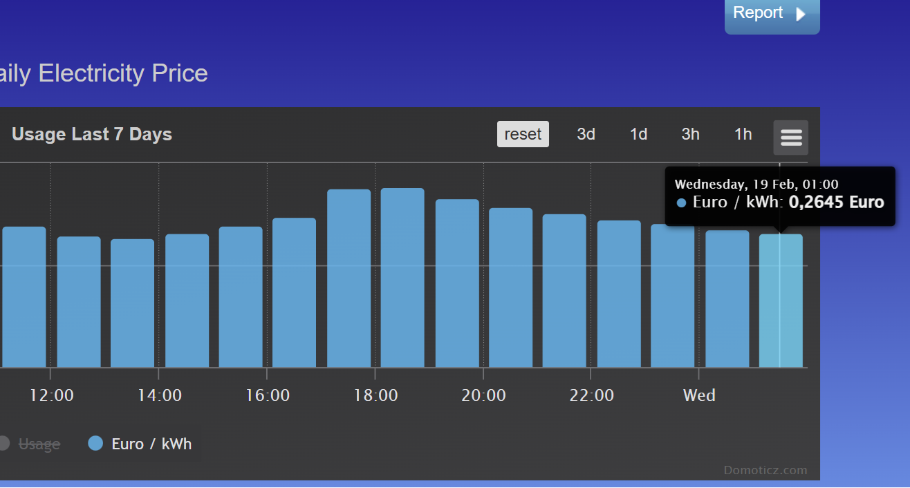

Sometimes the values from Enever have null values as shown below:
"datum": "2025-02-19 01:00:00",
"prijs": "0.099700",
"prijsANWB": "0.277377",
"prijsBE": "0.264487",
"prijsEE": "0.265277",
"prijsEN": "0.269137",
"prijsEVO": "0.277377",
"prijsEZ": "0.277377",
"prijsFR": "0.261697",
"prijsGSL": "0.277377",
"prijsMDE": "0.277377",
"prijsNE": "0.265397",
"prijsTI": "0.268302",
"prijsVDB": "0.265377",
"prijsVON": "0.263462",
"prijsWE": "0.268397",
"prijsZG": "0.277377",
"prijsZP": "0.263497"
"datum": "2025-02-19 02:00:00",
"prijs": null,
"prijsANWB": null,
"prijsBE": null,
"prijsEE": null,
"prijsEN": null,
"prijsEVO": null,
"prijsEZ": null,
"prijsFR": null,
"prijsGSL": null,
"prijsMDE": null,
"prijsNE": null,
"prijsTI": null,
"prijsVDB": null,
"prijsVON": null,
"prijsWE": null,
"prijsZG": null,
"prijsZP": null
"datum": "2025-02-19 03:00:00",
"prijs": "0.097670",
"prijsANWB": "0.274921",
"prijsBE": "0.262031",
As a result the chart stops at 01:00 hours:
Is there something I can do to solve this?

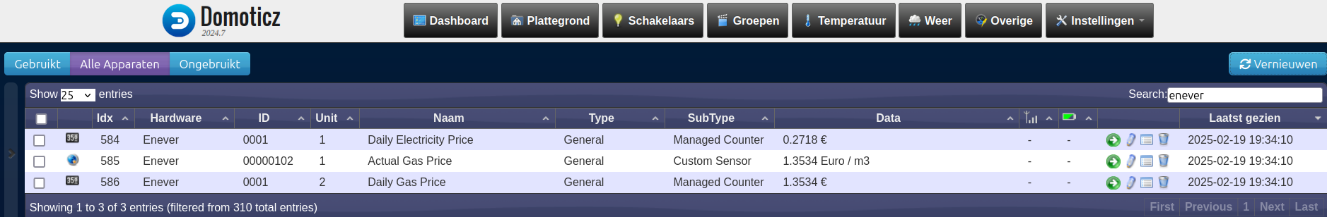

I deleted the Enever hardware, and added it again.
Now there are only 3 new devices added, not the one for Actual Electricity Price:

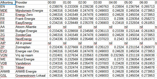

What might be your problem is that most of the time 1 or 2 suppliers didn't deliver their values, so your choice has NIL values.
These are the values for today.
I solved it by calculating the average value per hour of the data provided.
