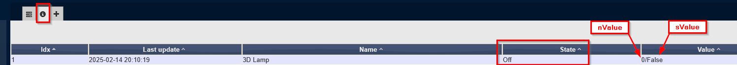

Did you try to change luxmeter.data to luxmeter.state?
domoticz.log('Lux Value: ' .. tostring(luxmeter.state), domoticz.LOG_INFO)
or the sValue
domoticz.log('sValue: ' .. luxmeter.sValue, domoticz.LOG_INFO)
Use the events information:
2025-02-15 15_20_58-Domoticz — Mozilla Firefox.png (9.76 KiB) Viewed 2037 times

        domoticz.log('Devicename: ' .. luxmeter.name, domoticz.LOG_INFO )
        domoticz.log('sValue: ' .. luxmeter.sValue , domoticz.LOG_INFO )
        domoticz.log('tostring sValue: ' .. tostring(luxmeter.sValue) , domoticz.LOG_INFO )
        domoticz.log('nValue: ' .. luxmeter.nValue , domoticz.LOG_INFO )
        domoticz.log('state: ' .. luxmeter.state , domoticz.LOG_INFO )
Output is now:
feb 16 17:34:00 domoticz domoticz[8321]: dzVents: LuxTEST: Devicename: Luxmeter
feb 16 17:34:00 domoticz domoticz[8321]: dzVents: LuxTEST: sValue:
feb 16 17:34:00 domoticz domoticz[8321]: dzVents: LuxTEST: tostring sValue:
feb 16 17:34:00 domoticz domoticz[8321]: dzVents: LuxTEST: nValue: 1
feb 16 17:34:00 domoticz domoticz[8321]: dzVents: LuxTEST: state:
Device status stated:
3867	2025-02-16 17:31:30	Luxmeter		1/454.0
3827	2025-02-16 17:31:40	Luxmeter		1/454.0
Tip change it to
timer = { "every minute"}
athoopen wrote: Sunday 16 February 2025 20:00 This one triggered me, it shows that I have two Luxmeters. I only have one. I ran the script again with the other idx, but the output is the same.
After this I removed both from Domoticz. Waited until the "hardware" added the luxmeter again, watching the log (really nice!!!) :
feb 16 17:46:39 domoticz domoticz[8321]: Tuya: Device name=Luxmeter id=bf8229507a9b71c4adakv3 category=lightsensor
feb 16 17:46:40 domoticz domoticz[8321]: Tuya: Device name= Luxmeter id= bf8229507a9b71c4adakv3 FunctionProperties= [{'code': 'find_me', 'desc': '{}', 'name': '找到我', 'type': 'Boolean', 'values': '{}'}]
feb 16 17:46:40 domoticz domoticz[8321]: Tuya: Device name= Luxmeter id= bf8229507a9b71c4adakv3 StatusProperties= [{'code': 'bright_state', 'name': '亮度检测状态', 'type': 'Enum', 'values': '{"range":["low","middle","high"]}'}, {'code': 'bright_value', 'name': '亮度值', 'type': 'Integer', 'values': '{"unit":"LUX","min":0,"max":1000,"scale":0,"step":1}'}, {'code': 'find_me', 'name': '找到我', 'type': 'Boolean', 'values': '{}'}]
feb 16 17:46:40 domoticz domoticz[8321]: Tuya: Device name= Luxmeter id= bf8229507a9b71c4adakv3 result= [{'code': 'bright_state', 'value': 'high'}, {'code': 'bright_value', 'value': 184}, {'code': 'find_me', 'value': False}]
feb 16 17:46:40 domoticz domoticz[8321]: Tuya: Device: bf8229507a9b71c4adakv3 Unit: 1 doesn't exsist. Nothing to update
Found that I forgot to delete the two lux meter switches (although I thought that it didn't influence anything, but you never know .. it's software :D ). Deleted them (now I have no "*lux*" devices which are listed). Waiting for a moment and looking at the log. Output was more or less the same, it also reported :
feb 16 18:01:52 domoticz domoticz[8321]: Tuya: Device: bf8229507a9b71c4adakv3 Unit: 1 doesn't exsist. Nothing to update
Oke .. Unpowered the luxmeter, went to my Tuya App and removed (remove and clear data) it there. Powered up again and added to the Tuya App.
Successful added (Virtual ID ends with bggll). Back to the log of domoticz:
feb 16 18:17:02 domoticz domoticz[8321]: Tuya: handleThread: 1 line 2545
feb 16 18:17:02 domoticz domoticz[8321]: Tuya: Device name=Luxmeter id=bf8229507a9b71c4adakv3 category=lightsensor
feb 16 18:17:02 domoticz domoticz[8321]: Tuya: handleThread: Credentials are incorrect or tuya subscription has expired! line 981
I don't know if the lasts line is related to the light sensor.... Nevertheless I will first have dinner :D , who knows it's then added ...
Nope .. maybe a restart of domoticz might help ... YES!
Looking at the log:
feb 16 19:50:55 domoticz domoticz[12803]: Tuya: Device name=LightSensor id=bff27908b7c1fb3e1bggll category=lightsensor
feb 16 19:50:55 domoticz domoticz[12803]: Tuya: Device name= LightSensor id= bff27908b7c1fb3e1bggll FunctionProperties= [{'code': 'find_me', 'desc': '{}', 'name': '找到我', 'type': 'Boolean', 'values': '{}'}]
feb 16 19:50:55 domoticz domoticz[12803]: Tuya: Device name= LightSensor id= bff27908b7c1fb3e1bggll StatusProperties= [{'code': 'bright_state', 'name': '亮度检测状态', 'type': 'Enum', 'values': '{"range":["low","middle","high"]}'}, {'code': 'bright_value', 'name': '亮度值', 'type': 'Integer', 'values': '{"unit":"LUX","min":0,"max":1000,"scale":0,"step":1}'}, {'code': 'find_me', 'name': '找到我', 'type': 'Boolean', 'values': '{}'}]
feb 16 19:50:55 domoticz domoticz[12803]: Tuya: Device name= LightSensor id= bff27908b7c1fb3e1bggll result= [{'code': 'bright_state', 'value': 'middle'}, {'code': 'bright_value', 'value': 67}, {'code': 'find_me', 'value': False}]
feb 16 19:50:55 domoticz domoticz[12803]: Tuya: Run Startup script
feb 16 19:50:55 domoticz domoticz[12803]: Tuya: Create device light sensor
feb 16 19:50:55 domoticz domoticz[12803]: Tuya: (Tuya) Creating Unit 'LightSensor'.
feb 16 19:50:55 domoticz domoticz[12803]: Tuya: Update devices in Domoticz
feb 16 19:50:55 domoticz domoticz[12803]: Tuya: Update device value: bff27908b7c1fb3e1bggll Unit: 1 sValue: 67.0 nValue: 1 TimedOut=0
But I now have still two Luxmeters .... One with idx 3874, and one with 3875 :?: Let's run the script for both, first 3874
feb 16 19:56:00 domoticz domoticz[12803]: dzVents: LuxTEST: Devicename: LightSensor
feb 16 19:56:00 domoticz domoticz[12803]: dzVents: LuxTEST: sValue:
feb 16 19:56:00 domoticz domoticz[12803]: dzVents: LuxTEST: tostring sValue:
feb 16 19:56:00 domoticz domoticz[12803]: dzVents: LuxTEST: nValue: 1
feb 16 19:56:00 domoticz domoticz[12803]: dzVents: LuxTEST: state:
and then 3875
feb 16 19:57:00 domoticz domoticz[12803]: dzVents: LuxTEST: Devicename: LightSensor
feb 16 19:57:00 domoticz domoticz[12803]: dzVents: LuxTEST: sValue:
feb 16 19:57:00 domoticz domoticz[12803]: dzVents: LuxTEST: tostring sValue:
feb 16 19:57:00 domoticz domoticz[12803]: dzVents: LuxTEST: nValue: 1
feb 16 19:57:00 domoticz domoticz[12803]: dzVents: LuxTEST: state:
How to continue?
Okay that is strange, Are you sure you don't have the plugin installed two times?
I did a test with a lux meter i got this:
2025-02-16 21:47:00.103  dzVents: LuxTEST: Devicename: Motion Sensor (Lux)
2025-02-16 21:47:00.103  dzVents: LuxTEST: sValue: 100
2025-02-16 21:47:00.103  dzVents: LuxTEST: tostring sValue: 100
2025-02-16 21:47:00.103  dzVents: LuxTEST: nValue: 0
2025-02-16 21:47:00.104  dzVents: LuxTEST: state: 100
I see the problem! category=lightsensor i did a merge of the sensor's but didn't do lightsensor, i will update the plugin.
Edit:
New version pushed, pull the new version and remove the old lux device then reboot Domoticz an new lux device is installed and is working with your script.
HP T630 (256GB SSD/8GB Mem) - Ubuntu 24.04.3 LTS (64Bit) - Domoticz 2025.2 (Docker) Machinon theme - RFLink - KaKu - Sonoff - Tasmota - Shelly - MQTT2Zigbee - OpenTherm Gateway - Tinytuya - IR Blaster - P1 Smart Meter - NPN Watermeter - Google Assistant
