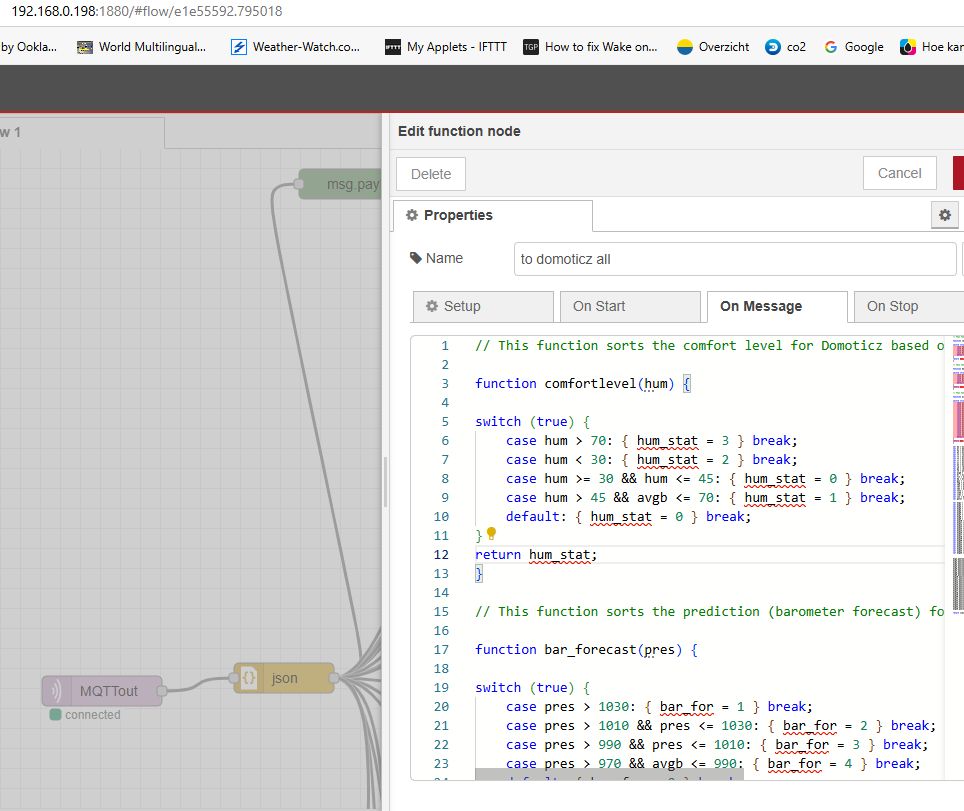

Hi all
As I had a very well working node-red script from FireWizard 5 years ago I had to renew it to a new Domoticz version (not compatible)
See this forum
The script what is still working in old node-red gives me errors in new node-red version (latest):
'The workspace contains some nodes that are not properly configured.
Its all about hum_stat and bar_for;
Cannot find name 'hum_stat'.(2304)
See attachements old and new node-red versions
What the difference and the solution to let it function proper again ?

the variable is not declared
try to set
var hum_stat = 0;
to the fourth line
the same to bar_for

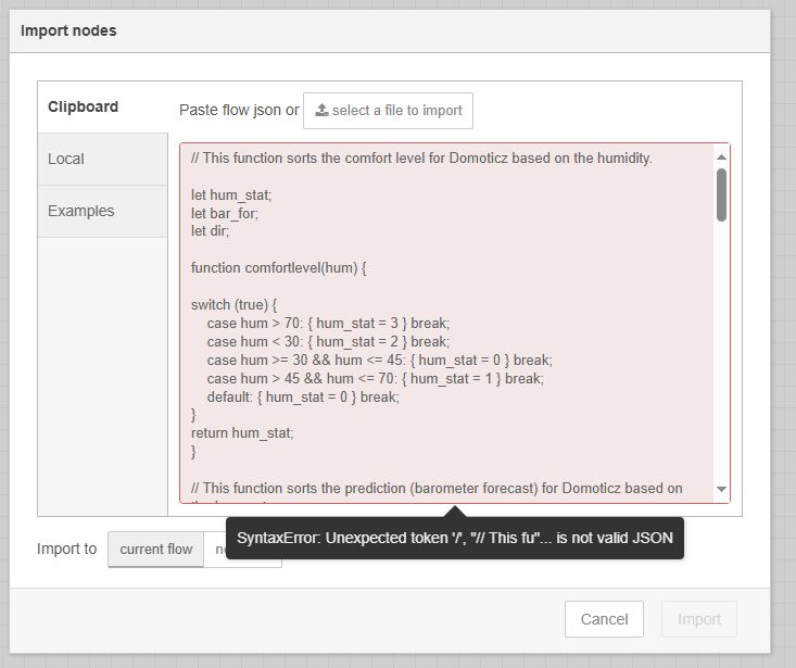

Hello @edje1205;
I asked you:
Can you send me your complete flow (not only the contents of the "Function" node, so that I can take a look to it in my test system.
This is not needed anymore as I already loaded the flow in my test system.
In December 2020, you must have used an older version of Node-RED. Probably something like 1.2.6.
This old version of NR was obviously not that strict on declarations of functions in a "Function" node and
that version did not show the missing declarations.
@habahabahaba mentioned also that these declarations were missing. I added them.
The flow ran well, even without the declarations, but this looks much better.
I added 3 declarations as follows:
let hum_stat;
let bar_for;
let dir;
I also updated all other declarations and changed every "var" to "let".
The contents of the "Function" node should now be as follows:

edje1205
Posts: 34
Joined: Tuesday 20 December 2016 12:09
Domoticz version: 3.5877
Location: Amsterdam Nieuwendam
Re: script not proper old vs new node-red version
Post by edje1205 »
try to set
var hum_stat = 0;
to the fourth line
the same to bar_for
did it !
started from scratch but think need some more advice later
FireWizard noticed your post later on will pay attention tomorrow on it
Thanks again both !!!!

Back again !
Was/Am struggling with RFLink Arduino mega 2560 board (not working send it back)
OT:
Thanks for input both: as said the first option worked prevent errors.
To day I wanted to investigate on FireWizard's script but got a syntax error by importing the script in node-red
SyntaxError: Unexpected token '/', "// This fu"... is not valid JSON
see att as well
but I don't understand; the script is as same as the original script !? Is it ?
syntax error node-red json.jpg (46.83 KiB) Viewed 6098 times
FireWizard
Posts: 1980
Location: Voorthuizen (NL)
Post by FireWizard »
Hello @edje1205,
Oh yes, this is clear to me.
What happened?
The code, I posted in my flow, is not a complete flow or even a part of a flow.
This code is the contents of the "Function" node, that is used in the flow.
To use this, do as follows:
1. Do not use the Node-RED import function!
2. Just press "Select all" and then "Copy" the code and "Paste" this code in the "Function" node.
OR
Use your own existing "Function" node and add
let hum_stat;
let bar_for;
let dir;
as line 3, 4 and 5 in your existing node.
Let me know.
