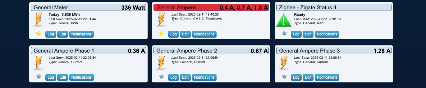

Anything wrong ? The script just stopped working. Looks it is not triger anymore
pipiche
Posts: 2027
Post by pipiche »
I have the here after script running. It helps to consolidate in Ampere3, 3 Ampere devices.
The 3 Ampere devices are updating on a regular basic, but suddenly the script stopped to be trigger, nothing happen after 19:40 , while the 3 devices are still updated !
Screenshot 2025-02-11 at 22.16.03.png (70.94 KiB) Viewed 1572 times
Feb 11 14:30:18 pi3 domoticz[722876]: 2025-02-11 14:30:18.737 dzVents: ------ Finished Consolidate-Current.lua
Feb 11 14:45:19 pi3 domoticz[722876]: 2025-02-11 14:45:19.377 dzVents: ------ Start external script: Consolidate-Current.lua: Device: "General Ampere Phase 1 (Zigbee)", Index: 96
Feb 11 14:45:19 pi3 domoticz[722876]: 2025-02-11 14:45:19.385 dzVents: ------ Finished Consolidate-Current.lua
Feb 11 15:50:19 pi3 domoticz[722876]: 2025-02-11 15:50:19.109 dzVents: ------ Start external script: Consolidate-Current.lua: Device: "General Ampere Phase 2 (Zigbee)", Index: 100
Feb 11 15:50:19 pi3 domoticz[722876]: 2025-02-11 15:50:19.117 dzVents: ------ Finished Consolidate-Current.lua
Feb 11 17:00:18 pi3 domoticz[722876]: 2025-02-11 17:00:18.762 dzVents: ------ Start external script: Consolidate-Current.lua: Device: "General Ampere Phase 2 (Zigbee)", Index: 100
Feb 11 17:00:18 pi3 domoticz[722876]: 2025-02-11 17:00:18.769 dzVents: ------ Finished Consolidate-Current.lua
Feb 11 17:10:18 pi3 domoticz[722876]: 2025-02-11 17:10:18.830 dzVents: ------ Start external script: Consolidate-Current.lua: Device: "General Ampere Phase 1 (Zigbee)", Index: 96
Feb 11 17:10:18 pi3 domoticz[722876]: 2025-02-11 17:10:18.839 dzVents: ------ Finished Consolidate-Current.lua
Feb 11 19:40:28 pi3 domoticz[722876]: 2025-02-11 19:40:28.732 dzVents: ------ Start external script: Consolidate-Current.lua: Device: "General Ampere Phase 2 (Zigbee)", Index: 100
Feb 11 19:40:28 pi3 domoticz[722876]: 2025-02-11 19:40:28.740 dzVents: ------ Finished Consolidate-Current.lua

Posts: 6689
Domoticz version: 2025.1
Re: Anything wrong ? The script just stopped working. Looks it is not triger anymore
I never have seen this before. Perhaps restart Domoticz to see if that helps.
