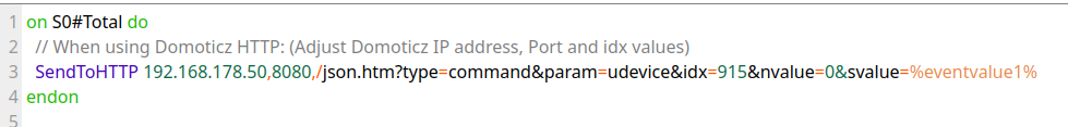

I try to update the Electricity_(instant_and_counter) with the following command from my espeasy S0 devicewaltervl wrote: Sunday 02 February 2025 23:40 A solar inverter normally gives its total energy (In kWh or Wh) and its current generated Power (in Watt).
If these values are given by your inverter they normally should be supplied to an Electricity (Instand and counter) device
https://wiki.domoticz.com/Dummy_for_vir ... d_counter)
That device should be set to type Return so it can be used as solar input in the Energy dashboard
SendToHTTP 192.168.178.50,8080,/json.htm?type=command¶m=udevice&idx=915&nvalue=0&svalue=%eventvalue1%If I try a different type sensor such as manage counter it does work. How must I adapt this call in a way that update the Electricity_(instant_and_counter)?

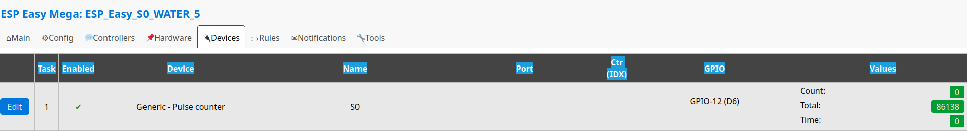

The total count from my espeasy S0 I want to send to the Electricity_(instant_and_counter)
- espeasy S0
- Schermafdruk van 2025-02-07 15-59-35.png (27.51 KiB) Viewed 5309 times
- rule for sending to Electricity_(instant_and_counter)
- Schermafdruk van 2025-02-07 15-59-15.png (39.96 KiB) Viewed 5309 times

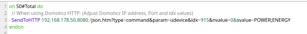

Thanks both for your help, you mean this?
I 'am not very good in this.
- Schermafdruk van 2025-02-07 16-27-24.png (27.73 KiB) Viewed 5300 times

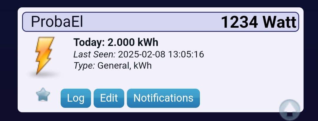

In my case work
but for p1 smart meter it will not work for that you need through a script
- Screenshot_20250208_130543_Chrome.jpg (76.85 KiB) Viewed 4047 times

There is some progress when I use your call. Only "Vandaag"is giving a value but not on top. Have I forgotten something?
- Schermafdruk van 2025-02-08 13-31-16.png (71.66 KiB) Viewed 4035 times
