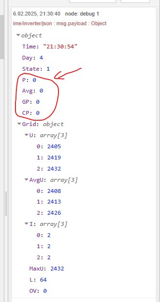

1. I am sending a screenshot of what I would like to have highlighted in Domoticz.
2. In domoticz I can create sensors, the question is which ones?
3. I would like to use the data in the energy panel and to control heaters in blockly.
4. MQTT server or is it a broker? I have a broker because in domoticz I have data from shelly, and various sensors on Tasmota.

Hello @Daro1003,
You wrote:
I see:
P, Avg, GP and CP, but I need some extra information.
I assume, as the device is a solar-inverter, that
P represents the Power (the totally produced Power?)
Avg represents probably some Average, but the average of what? The Power?
GP stands for what (Grid Power?) and what does CP mean? (Consumed Power?)
I need to know what these payloads mean in order to configure the correct virtual hardware in Domoticz.
This has also effect on the data we will send to Domoticz by MQTT.
You can also control the heaters directly from Node-RED. This will give you more possibilities,as Blockly has its limitations.
But you may find an answer at: https://stackoverflow.com/questions/573 ... t-a-server or
https://electronics.stackexchange.com/q ... -vs-server
Personally I use more often the word "server", but I agree with the explanations, given in those links.
So a MQTT broker and a MQTT server are the same device. You have one available and we will use that one.
If you can answer my questions, we can make the next step and create a "Function" node with the correct data to Domoticz.

P represents the Power (the totally produced Power?) - YES
Avg represents probably some Average, but the average of what? The Power? - YES
GP stands for what (Grid Power?) YES and what does CP mean? (Consumed Power?) - YES
average Power is not used in this case.
Everything is as you write

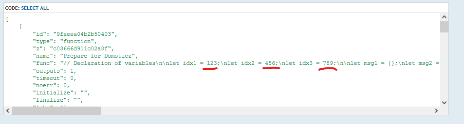

For all 3 sensors you can create Electric (Instant + Counter).
Edit the sensors and for the Grid Power use the 'Type" : 'Usage" and "Energy read' to "Computed".
The Consumed Power can be the same.
The total produced Power should be set to "Type" "Return" and "Energy read' to "Computed".
If not, study the Node Red essentials on their web page.
Then i suggest to create a Dummy hardware (does nothing) with 3 sensorsaverage Power is not used in this case.
I hope you can insert a Function node in the Node-RED flow together with a MQTT Out node.Unfortunately I can't use NodeRed

I have NodeRed installed on a raspberry that has domoticz and I can insert some flow.
Wouldn't it be better to send each parameter in a separate Domoticz block?
I meant that I will build automation on domoticz but I need data from the inverter.

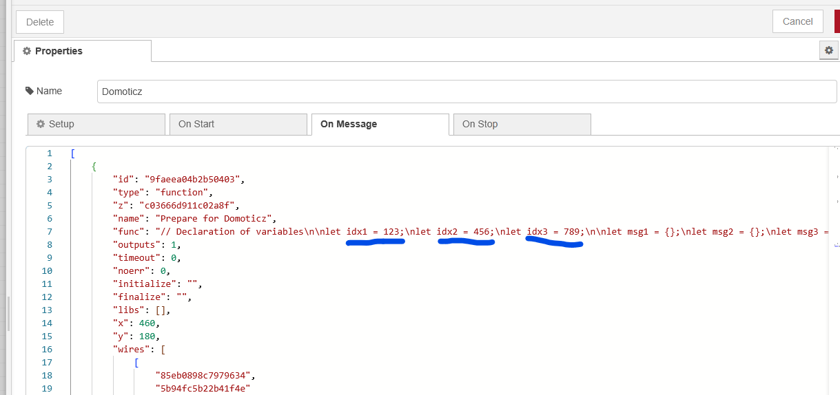

Do I insert my own IDX from domoticz in these underlined places?
- Zrzut ekranu 2025-02-13 161559.png (15.68 KiB) Viewed 2748 times
- Zrzut ekranu 2025-02-13 161108.png (35.1 KiB) Viewed 2748 times

Hi @Daro1003
If I look to your screenshots, I think you have tried to insert the flow into a "Function" node.
That is not the intention.
You should do it as follows:
Select and copy the Flow from the Domoticz Forum page, as you have done before.
Click "SELECT ALL" and next press CTRL-C (Copy).
Open Node-RED editor and go to the "Hamburger" menu and Select "Import" .
In the editor field , press Ctrl-V (Paste).
This will insert the complete flow in the import window.
Next press "Import'.
This will open the flow, as shown in my previous post, in its own tab, marked "Sofar 15KTL-X inverter"
Edit the "Function" node as follows:

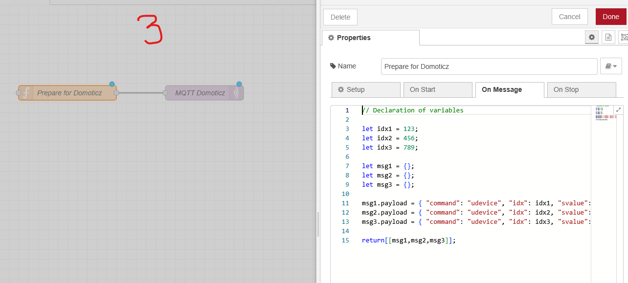

This is how the "Function" node looks like:Do the following:
Edit the "Function" node and replace in line 3, your Domoticz idx number for P.
Do the same in line 4 for GP and in line 5 for CP.
Use your own MQTT configuration.
// Declaration of variables
let idx1 = 123;
let idx2 = 456;
let idx3 = 789;
let msg1 = {};
let msg2 = {};
let msg3 = {};
msg1.payload = { "command": "udevice", "idx": idx1, "svalue": msg.payload.P.toString() + ";0"};
msg2.payload = { "command": "udevice", "idx": idx2, "svalue": msg.payload.GP.toString() + ";0" };
msg3.payload = { "command": "udevice", "idx": idx3, "svalue": msg.payload.CP.toString() + ";0" };
return[[msg1,msg2,msg3]];-

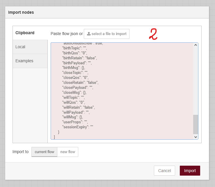

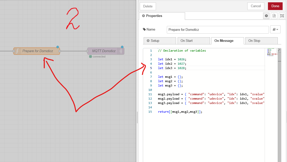

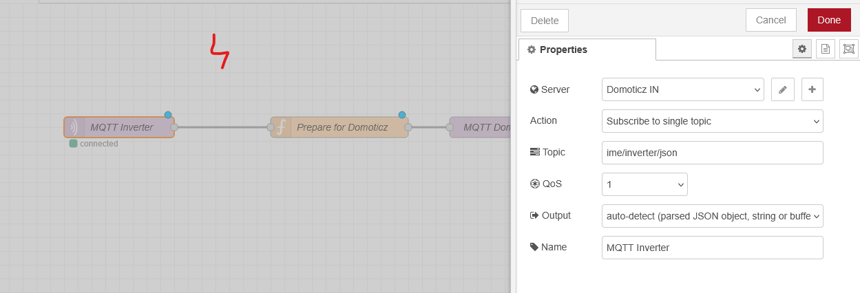

So I click on options and it gives me import.
In the window as in image 2 I paste what you gave and click import.
I see two node as in image 3, I click on node F and I have it as in image 3 and there I change the IDXs to my own?
Why when I click import only 2 node appear and not 5 like in your case?
And what next? I create a node as in image 4 ??

- FireWizard
- Posts: 1968
- Location: Voorthuizen (NL)
Re: Node Red -> Domoticz help with setting up transfer
Hello @Daro1003,
You only get 2 nodes, because I only sent you these 2 nodes.
If I would send my test nodes as well, this would cause more confusion.
The only thing you should do now is:
1. Edit the "Function" node, called "Prepare for Domoticz" and insert your IDX numbers, instead of 123, 456 and 789.
Leave the rest as it is.
2. Connect the input of that "Function" node, called "Prepare for Domoticz" to the output of your MQTT Output node, called "MQTT Inverter".
I see you have obviously configured a MQTT Server (Broker), called "Domoticz IN".
A MQTT server is not only intended for Domoticz, but also for other applications.
It is also not only intended for IN, but is also used for data from Domoticz.
So the name "Domoticz IN" is rather confusing.
Try it this way and let us know.

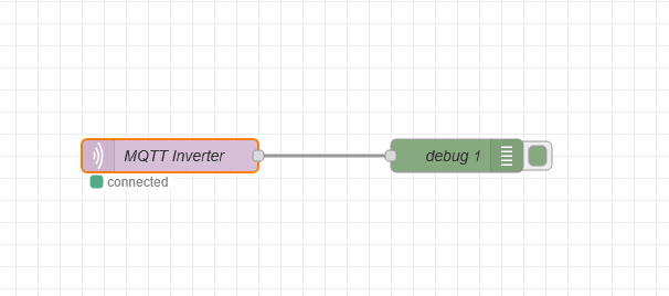

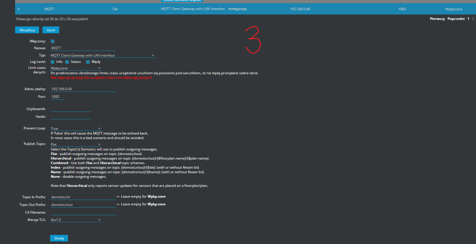

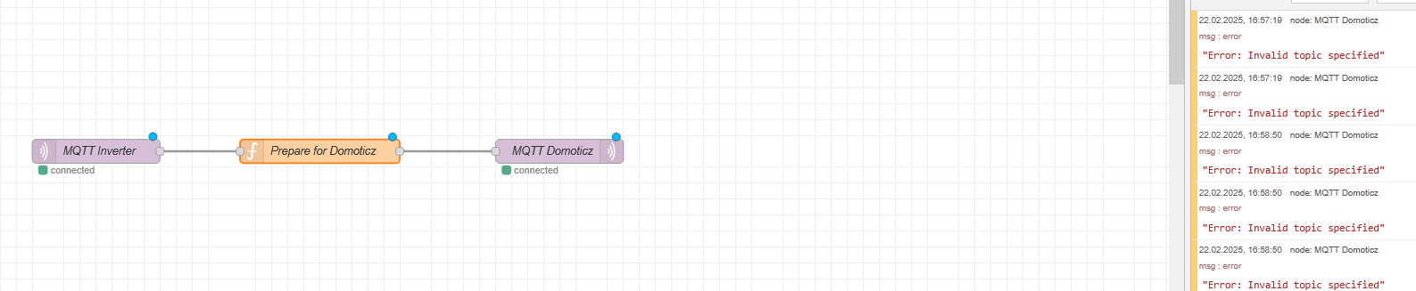

Please help me further.
Image 1 I changed the IP address that my Raspberry has with Domoticz.
Image 2 I changed the IDX in domoticz created 3 blocks
Image 3 Domoticz MQTT
It doesn't work
The connection is probably ok because when I change the IP address the green "connected" sign disappears
It doesn't work
- Zrzut ekranu 2025-02-22 171128.png (51.52 KiB) Viewed 1598 times
- Zrzut ekranu 2025-02-22 172027.png (54.28 KiB) Viewed 1598 times
- MQTT Cliebnt Gatway.png (84.55 KiB) Viewed 1598 times

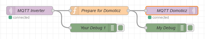

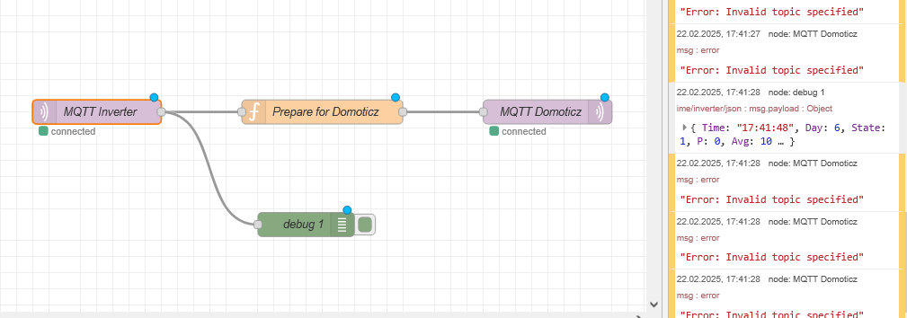

Next to it in the table there is still ERROR:
If I add debug to MQTT Inverter I get the following data:
- Debug.png (34.77 KiB) Viewed 1597 times
- Zrzut ekranu 2025-02-22 171945.png (30.48 KiB) Viewed 1598 times

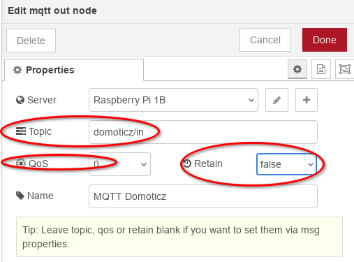

- FireWizard
- Posts: 1968
Hi @Daro1003,
Your MQTT Setting is not complete.
Make the following setting:
Use as topic domoticz/in and (less important) set QoS to 0 and Retain to false.
Try again and let me know.
