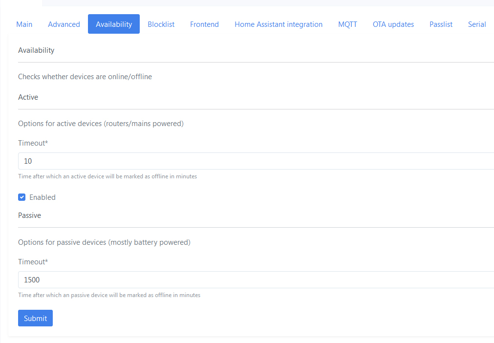

Exactly, it would be wonderful to reporting if a switch device lost its connection from the zigbee mesh. At the moment I can only see this in zigbee2mqtt dashboard. Regarding the option https://www.zigbee2mqtt.io/guide/config ... ility.html it is already activated in zigbee2mqtt general settings but without success in domoticzwaltervl wrote: Monday 03 February 2025 13:44 I think zigbee2MQTT users are aiming at reporting if a switch device lost its connection from the zigbee mesh.

Do you see with MQTT explorer that an availability message is sent? You could easily test these if you have a zigbee bulb that you can switch off with the external power. Is should send an offline message after 10 minutes.

I checked in Mqtt Explorer for offline device i have:
availability={"state" : "offline"}
but every 10 minutes in zigbee2mqtt logs i have this message:
warning z2m: Failed to ping 'Ac socket' (attempt 1/1, ZCL command 0x00158d0001f555ec/1 genBasic.read(["zclVersion"], {"timeout":10000,"disableResponse":false,"disableRecovery":true,"disableDefaultResponse":true,"direction":0,"reservedBits":0,"writeUndiv":false}) failed (Data request failed with error: 'MAC no ack' (233)))

So that is good. The warning also means the device is offline.
If you enable that device again that warning message should not appear anymore and the availability message should switch to "online".

Exactly, if the device is enable...we have availability={"state" : "online"}
