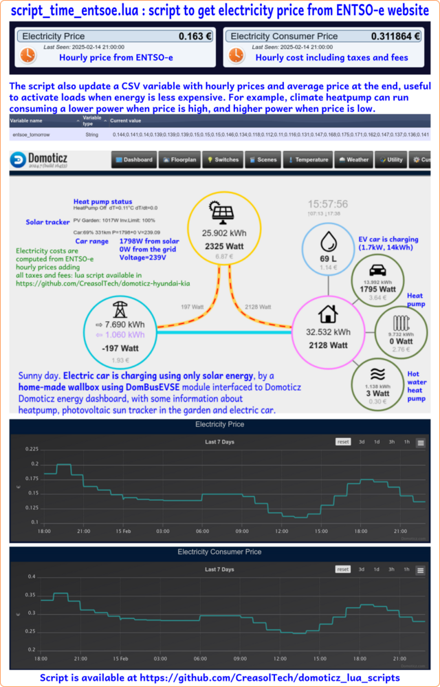

In Italy only few electricity suppliers have hourly tariffs.... most tariffs depends from the montly average price of energy for 3 time slots (23÷7, 7÷8 + 18÷23, 8÷18) and some tariffs are flat (you can consume energy at any time, paying always the same tariff), and this is very bad because it does not encourage users to consume energy when it costs less.
Since Feb 2022 (Ukraine war) I changed the automation (lua script) that manages the heat pump to reduce consumption and export energy during the peak hours (from 7 to 9 and from 18 to 21), to "help" the electricity grid, but this should be done by everyone, not only by me! ;-)
I've wrote in https://www.creasol.it/en/support/domot ... c-forecast all info about scripts to download ENTSO-e prices and compute the solar production forecast, very useful information to control the heat pump and other loads.
It's a pity that in LUA script it's not possible to update a counter device with further values (prices and solar production for tomorrow, hour by hour): only dzVents permits to do that.

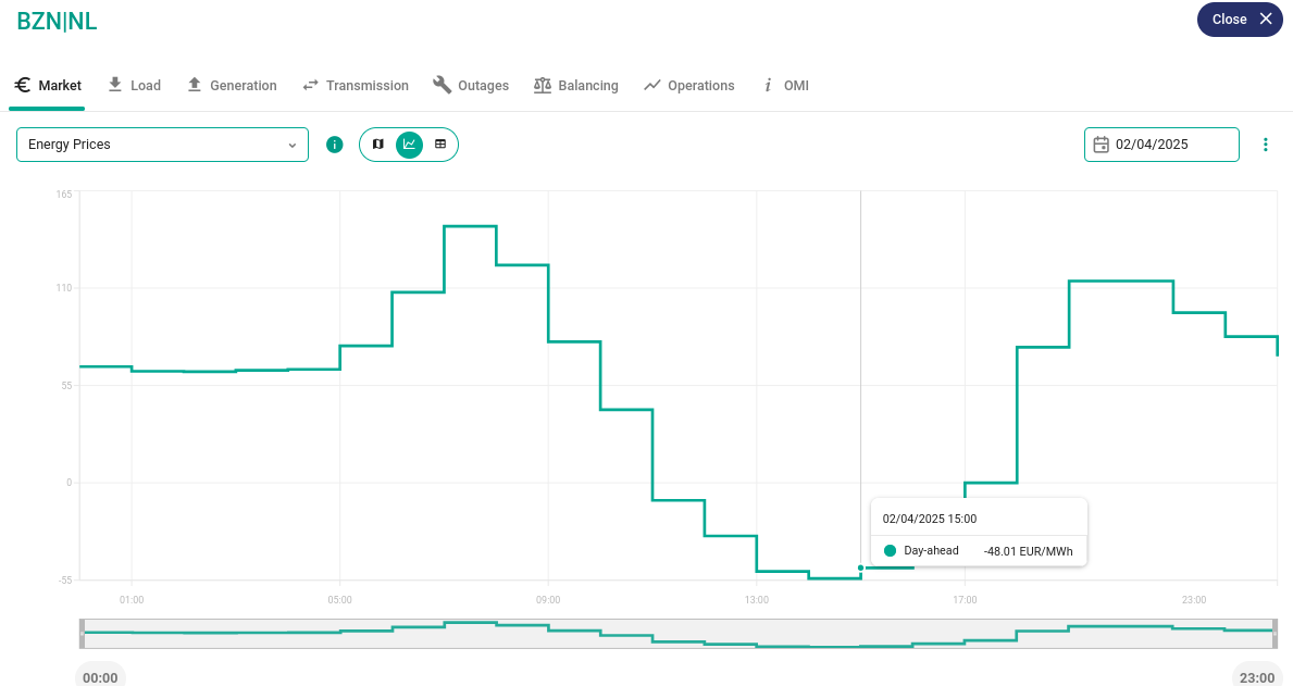

Now you have negative prices during the day, as shown in the picture below (electricity price in NL today), and the solution is store that energy in vehicle or house battery, and make new storage systems (battery, water, green hydrogen, ...) and try to export this energy to other countries.
