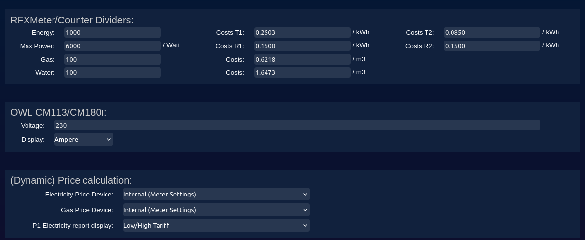

These are my settings

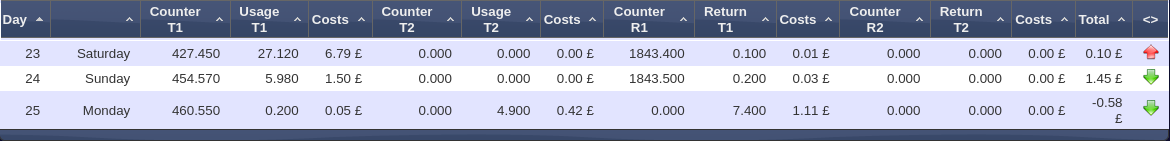

If you check the report page of this device the issue should be more clear as it shows T1/T2 usage and costs per day.

Ahh, I was not aware that a daily display could be also reported: thanks! It's strange...by looking at the table below the costs for Monday should be 0.05+0.42-0.01=0.46, but the total in the last column is £1.25. So it seems that the T1/R1 vs T2/R2 is calculated correctly but the sum is incorrect. Also, for some reason the R1 counter is at zero...waltervl wrote: Monday 25 November 2024 8:58 If you check the report page of this device the issue should be more clear as it shows T1/T2 usage and costs per day.

As you are doing the split to Usage T1/T2 and Return T1/T2 yourself you have to check the database values in the Multimeter table to be sure.
Also let it run for a couple of days to check if the data is still valid. Every night at 12 the SQLIte database is cleaned up and P1 summary data is moved from Multimeter table to Multimeter_Calendar table.

This is fixed now (reported again as GitHub issue #7185, commit 5af137ff0, in the next beta).
With the prices from the meter settings, Domoticz only knew which tariff was active from a P1 USB/LAN meter. A P1 device that is fed by a plugin, MQTT or a script (like your Solax setup) was therefore always priced at T1.
Now every counter uses its own tariff: T1 usage at T1, T2 usage at T2, and returned energy at R1/R2, for the daily cost and for the hourly cost chart. Costs already stored for earlier days are not recalculated.
