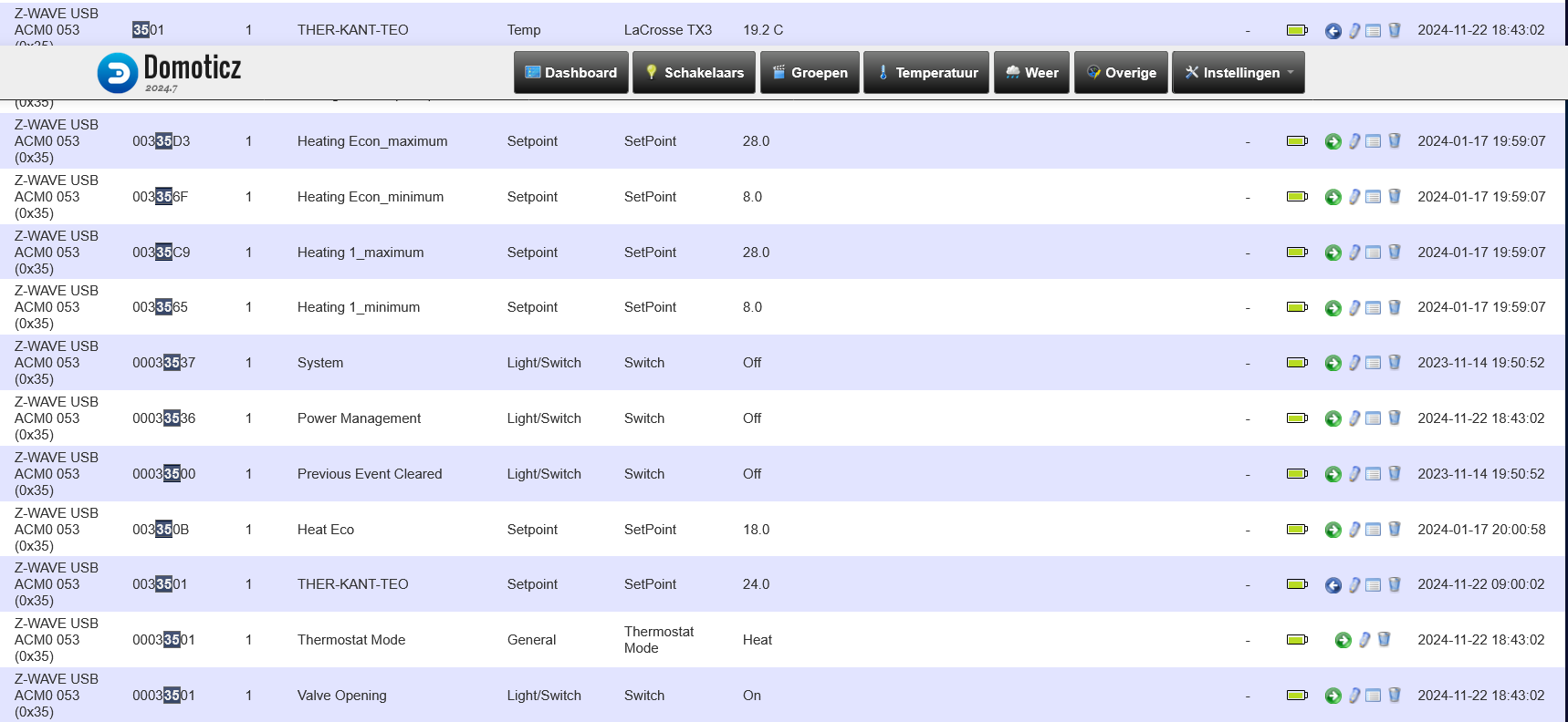

I can no longer get a set point setting with my Eurotronic spirit thermostat
This is a new installation of a Eurotronic spirit, the old ones do have a set point
I have already tried various things
Screenshot 2024-11-22 at 20-45-36 Domoticz geen setpoint.png (93.18 KiB) Viewed 4363 times
Screenshot 2024-11-22 at 20-44-37 Domoticz setpoint.png (161.34 KiB) Viewed 4363 times

Openwave integration does not support the new setpoint device, migrate to Zwave-JS-UI, see also viewtopic.php?p=321181#p321181
