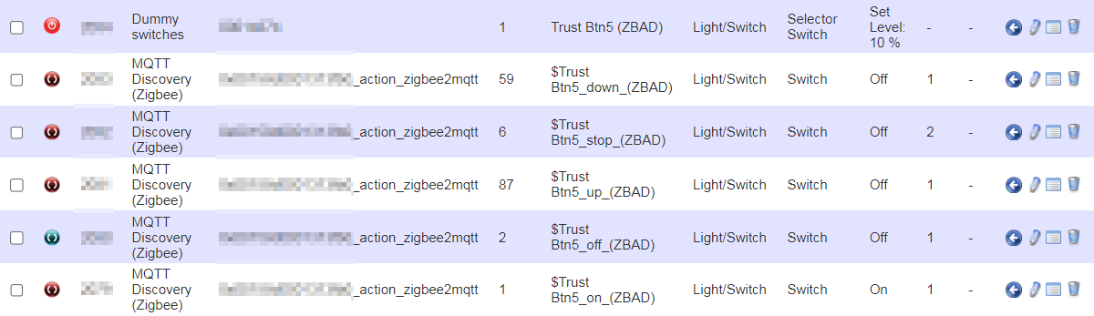

These are the devices I created:
2024-11-17 14_39_54-Domoticz.png (52.5 KiB) Viewed 3203 times

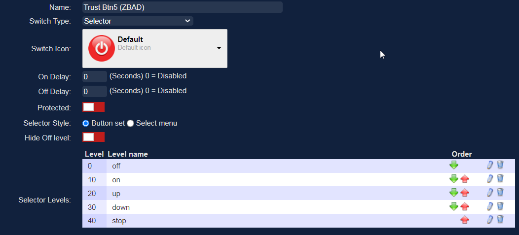

This is the configuration of the selector switch. Make sure the level names match the names of the hidden devices.
2024-11-17 14_46_16-Domoticz.png (36.69 KiB) Viewed 3203 times
