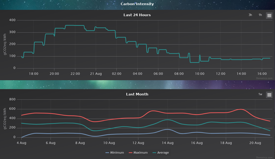

Unfortunately the countries (areas) emission factors are not fixed. It are variables, which are updated every hour.
To give you an impression of the variations, see the log file of the sensor below.
During the night hours the value is higher than during the day, as in the night the big solar farms are not contributing to the total energy production.
On the Nowtricity site I cannot find a statement about the resolution, but you can see it, if you look to the returned data of their API.
Electricity Maps is clear as it states:
Resolution
All endpoints return data with a resolution of 1 hour.
So this has to be entered once (or with a 'get' button that calls an API to get those for your country)
No, at least once an hour you have to call an API and if that API gives you also the factor of fossil-free consumption or renewable consumption, then there is no need to calculate this value yourself.
As Electricity Maps does exactly this, there was no need for me to look further.
