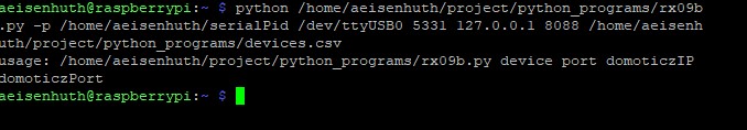

Nothing happens except for the message in the log
Maybe you have a solution Wim R??? Best regards

seems 127.0.0.1 5331 is not responding.
Does the serproxy runs?
regards
regards

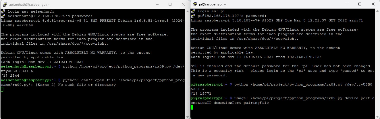

aeisenhuth
- Posts: 46
- Joined: Thursday 26 January 2017 21:07
- Location: Homberg, Hessen, Germany
Re: Eldat Easywave RXR09 Script
Hör i Can Test of the serproxy Works? Or how i Can activate it.
Best regards
Best regards

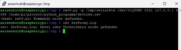

if on the Pi you type:
rx09.py -p /tmp/serialPid /dev/ttyUSB0 5331 127.0.0.1 8080 /home/pi/project/python_programs/devices.csv
the /home/pi/project/python_programs/devices.csv pointing to the data file with the links between the senders and the corresponding idx of the devices in Domoticz
it should yield info on the proxy being able to start
and in/tmp you should find serialPid : a file with the process number of the proxy
and also in /tmp you should find a log file
regards

The SerialProxy.Log should be siomething like this:
/tmp $ cat SerProxy.Log
2024-11-10 11:04:12,688 INFO:Serial Device: /dev/ttyUSB0
2024-11-10 11:04:12,689 INFO:Port: 5331
2024-11-10 11:04:12,689 INFO:Domoticz IP: 127.0.0.1
2024-11-10 11:04:12,697 INFO:waiting for connection
2024-11-10 11:04:12,701 INFO:Serial port opened Serial<id=0x765d55f0, open=True>(port='/dev/ttyUSB0', baudrate=57600, bytesize=8, parity='N', stopbits=1, timeout=None, xonxoff=False, rtscts=False, dsrdtr=False)
2024-11-10 11:04:12,702 INFO:Device table being loaded in dictionnary.
2024-11-10 11:04:12,702 INFO:Device table being opened.
2024-11-10 11:04:12,713 INFO:Device table being closed.
2024-11-10 11:04:12,713 INFO:Device table loaded in dictionnary. Number of devices loaded: 8
2024-11-10 15:16:01,965 INFO:connected from: ('127.0.0.1', 49855)
2024-11-10 15:16:02,019 INFO:Message received: TXP,09,A
2024-11-10 15:16:02,024 INFO:Serial respons : OK

aeisenhuth
- Posts: 46
Unfortunately, I get the message: Command not found
- terminal.jpg (33.4 KiB) Viewed 4678 times

WimR
- Posts: 46
- Joined: Saturday 03 February 2018 17:18
- Domoticz version: 2020.2
- Location: Belgium
did you copy the rx09.py from your old pi to the new one in dir /home/pi/project/python_programs?
than
python /home/pi/project/python_programs/rx09.py -p /tmp/serialPid /dev/ttyUSB0 5331 127.0.0.1 8080 /home/pi/project/python_programs/devices.csv
shoudl startup the proxy
regards

aeisenhuth
- Posts: 46
left my new PI, right my old PI
- terminal2.jpg (149.63 KiB) Viewed 4674 times

aeisenhuth
- Posts: 46
Yes i copy it. On the Old PI it works, but the old PI hangs up every day
- terminal3.jpg (25.93 KiB) Viewed 4669 times

aeisenhuth
- Posts: 46
I use port 8088 and the user aeisenhuth. When I enter the command in the console:
python /home/aeisenhuth/project/python_programs/rx09.py -p /tmp/serialPid /dev/ttyUSB0 5331 127.0.0.1 8088 /home/aeisenhuth/project/python_programs/devices.csv
Then I get the following output:
File "/home/aeisenhuth/project/python_programs/rx09.py", line 18, in <module>
import json, urllib, urllib2
ModuleNotFoundError: No module named 'urllib2'
Unfortunately I'm not as proficient in Linux as you are, thank you very much for your support WimR

WimR
- Posts: 46
- Location: Belgium
haven't got time to test it yet but here's code that doesn't use the urllib2 module but the urllib3 module instead.
save the code under rx09b.py
rx09b.py -p /tmp/serialPid /dev/ttyUSB0 5331 127.0.0.1 8080 /home/pi/project/python_programs/devices.csv
I'll try some testing this evening
regards
