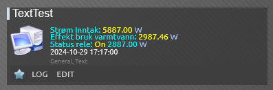

And the distane between line on the TextDevice..
It's like:
Text 1
Text 2
Text 3
I want:
Text 1
Text 2
Text 3
https://domoticz.com/forum/download/fil ... w&id=33247

Arne Kjetil
Skjermbilde 2024-10-28 232215.png (30.47 KiB) Viewed 4694 times
HvdW
Posts: 663
Domoticz version: 2023.2
Location: Twente
Re: Need Lua help here, no programer
Post by HvdW »
Beautiful!

Started with some ideas, roughly put together, mostly wrong code...
Got some experience with Basic (Bascom), Lua (Domoticz) and basic Excel.
But nothing advance...n
Will let it run for some time, find some bugs :lol:, and eventually put together some hardware
local MaxUse, NedreVannTemp = tonumber(uservariables['MaxUse']), tonumber(uservariables['NedreVannTemp'])
local extractedValue = tonumber(string.match(otherdevices_svalues['AMS strom forbruk'] or "", "%d+%.?%d*"))
local Effekt_bruk_varmtvann = tonumber(string.match(otherdevices_svalues['Effekt bruk varmtvann'], "%d+%.?%d*"))
local Varmt_Vann_Bereder = tonumber(string.match(otherdevices_svalues['Varmt Vann Bereder'], "%d+%.?%d*"))
local Volt1 = tonumber(string.match(otherdevices_svalues['AMS Spenning L1'], "%d+%.?%d*"))
local Volt2 = tonumber(string.match(otherdevices_svalues['AMS Spenning L2'], "%d+%.?%d*"))
local Volt3 = tonumber(string.match(otherdevices_svalues['AMS Spenning L3'], "%d+%.?%d*"))
local Volt = (Volt1 + Volt2 + Volt3) / 3 -- average voltage, skkert n�ye nok med 235V ??
local Varmt_Vann_Bereder_W = Volt * Effekt_bruk_varmtvann -- calculate wattage
local MaxUseDevice = extractedValue - 3000 -- example: 2100 = 5100 - 3000
-- Log values for debugging
print("extractedValue: " .. extractedValue)
print("Effekt bruk varmtvann: " .. Effekt_bruk_varmtvann)
print("Varmt Vann Bereder: " .. Varmt_Vann_Bereder)
print("Volt1: " .. Volt1)
print("Volt2: " .. Volt2)
print("Volt3: " .. Volt3)
print("Average Volt: " .. Volt)
print("Varmt Vann Bereder W: " .. Varmt_Vann_Bereder_W)
print("MaxUseDevice: " .. MaxUseDevice)
if MaxUseDevice <= MaxUse then
commandArray['Rele varmt vann virt'] = 'on'
Status = ON
print("Power bereder set to On")
commandArray['Rele varmt vann virt'] = 'Off'
print("Power bereder set to Off")
if Varmt_Vann_Bereder <= 50 then
--if Varmt_Vann_Bereder <= Nedre VannTemp then
commandArray['Rele varmt vann virt'] = 'On'
print("Rele varmt vann set to On due to Varmt Vann <= 50")
local Tekst1 = "<font color='Aqua'>Strøm Inntak: </font><font color='Yellow'>" .. string.format("%.2f", extractedValue) .. "</font> W<br>"
local Tekst2 = "<font color='Aqua'>Effekt bruk varmtvann: </font><font color='Yellow'>" .. string.format("%.2f", Varmt_Vann_Bereder_W) .. "</font> W<br>"
local Tekst3 = "<font color='Aqua'>Status rele: </font><font color='Yellow'>" .. otherdevices['Rele varmt vann virt'] .. "</font><font color='Aqua'> " .. string.format("%.2f", MaxUseDevice) .. "</font> W"
-- Combine the text values into one string
--local displayText = Tekst1 .. "\n" .. Tekst2 .. "\n" .. Tekst3
local displayText = "<div style='margin-bottom:-4px;'>" .. Tekst1 .. "</div>" ..
"<div style='margin-bottom:-3px;'>" .. Tekst2 .. "</div>" ..
"<div style='margin-bottom:-4px;'>" .. Tekst3 .. "</div>"
-- Update the text device with the combined text
ttidx = otherdevices_idx['TextTest']
print('TextTest idx '..ttidx)
commandArray['UpdateDevice'] = ttidx..'|0|'..displayText --newtext
return commandArray

Sometime have gone by, A HD has crashed, new install of Domoticz/Z-wave.
Still working on this script, it's working, but I want more ;)
At the moment in LUA..
  • Is it possible to dynamically change icon bases on a value ?
    Is it possible to remove or adjust "Last seen xx.xx.xxx. "
    Is it possible the remove or adjust the "Type, General, Text"
The answer is maybe hidden somewhere in the wiki/forum ..
The idea behind this script is to save electricity, as some part is based on the usages peak in a month, so it's wise to turn off the water heater when we are cocking food or using electricity...
AK

I am doing some small simple scripts in Lua, mainly to learn something, asked before but never got any answers.
What exactly can be done with a text device ?
where can I find more deeper info about the different devices in Domoticz ?
Maybe how to program some other devises too??
I learned that a text device:
  • Can display 4 or more lines.
    Can use http formatting on the text, colours, sizes, different text, bold++
    Can change icons, It would be nice if I could do this in pure Lua? not that into dzVents, more help to find in Lua..
    (got It working whit some 8080/json.htm?type=setused&used=true&name=*** code, thanks to and old post from warrenviewtopic.php?p=266340&hilit=change+icon+script#p266340 Thanks :)
And some help from https://domoticz-icon.aurelien-loyer.fr/, I say some help because the zip file doesn’t work right out of the ”box”, have to add the small file manually? but maybe I do something wrong?, it's a great help as long I know how to make it work.
Arne Kjetil
