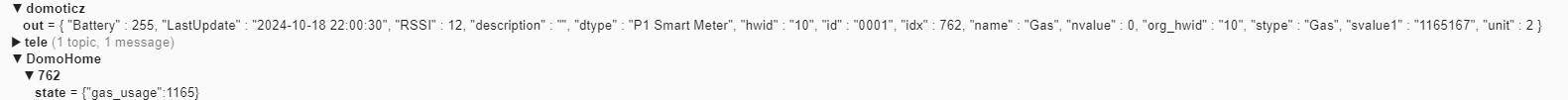

and this is what MQTT explorere says.
domoticz
out = { "Battery" : 255, "LastUpdate" : "2024-10-16 22:45:30", "RSSI" : 12, "description" : "", "dtype" : "P1 Smart Meter", "hwid" : "10", "id" : "0001", "idx" : 762, "name" : "Gas", "nvalue" : 0, "org_hwid" : "10", "stype" : "Gas", "svalue1" : "1165130", "unit" : 2 }

Walter, don't know what happened after I thought to have updated one of my posts it wasnot. Maybe forgot to submit again.
Having said this pls note: that when I send that value via Domoticz (settings>more options>send data>Mqtt) it sends 1165.
Can't copy a screenshot because the value is only visible in MQTT explorer once a value has changed. This did not happen for a few days as I didnot use gas.
Whereas I expect that hereunder is the result of P1 connection
So value sent out by Domoticz don't mention the decimal part.domoticz

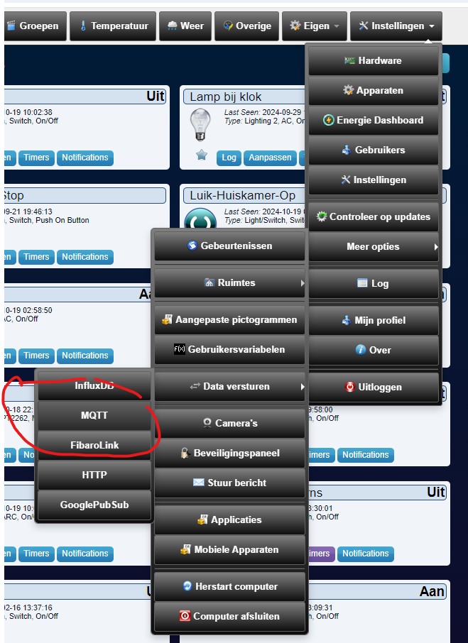

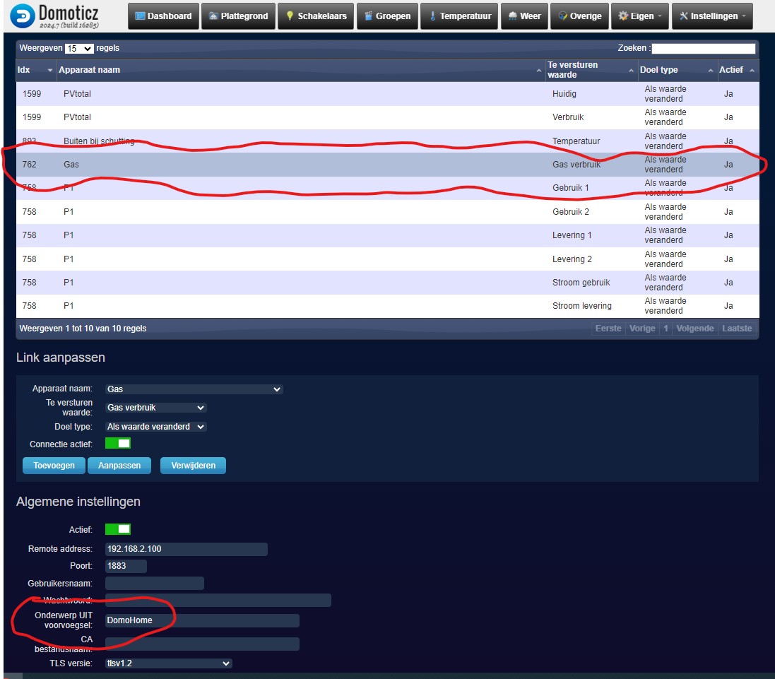

@Waltervl
Maybe there are more possibilities to get what you want but than still the question remains why MQTT sent via domoticz no complete value.
You asked how I got the DomoHome/762 topic.
See downbelow the screeshots.
