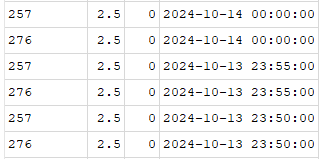

For the data from Wunderground I'm using the standard hardware from Domoticz, the data from the PWS is handled by the Wunderground Direct Receiver plugin (wudirect). The devices are created by these plugins and are both of type Rain, only the subtype differs. The data in the Rain and Rain_Calendar tables is exactly the same for both devices, including the timestamps.
In the Rain table there are records for both devices at midnight (00:00:00) with the total value for the day.
