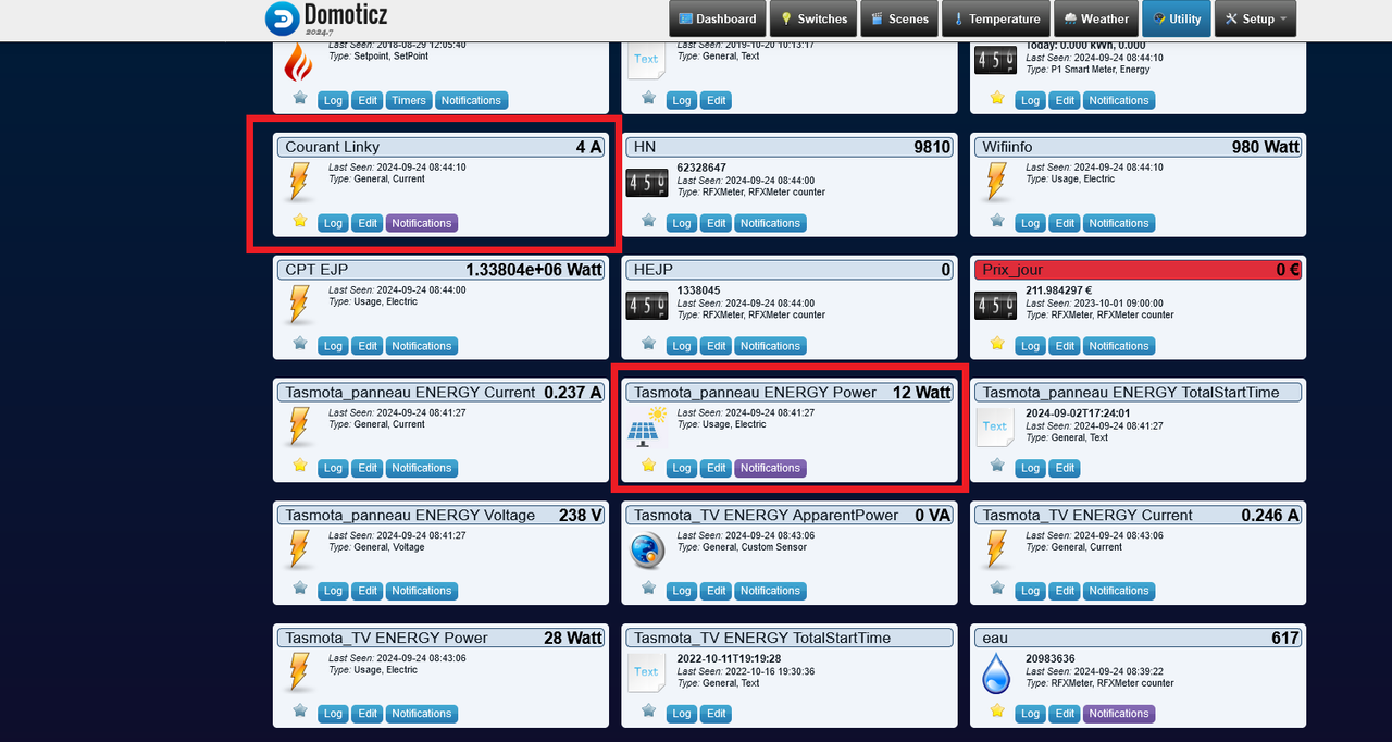

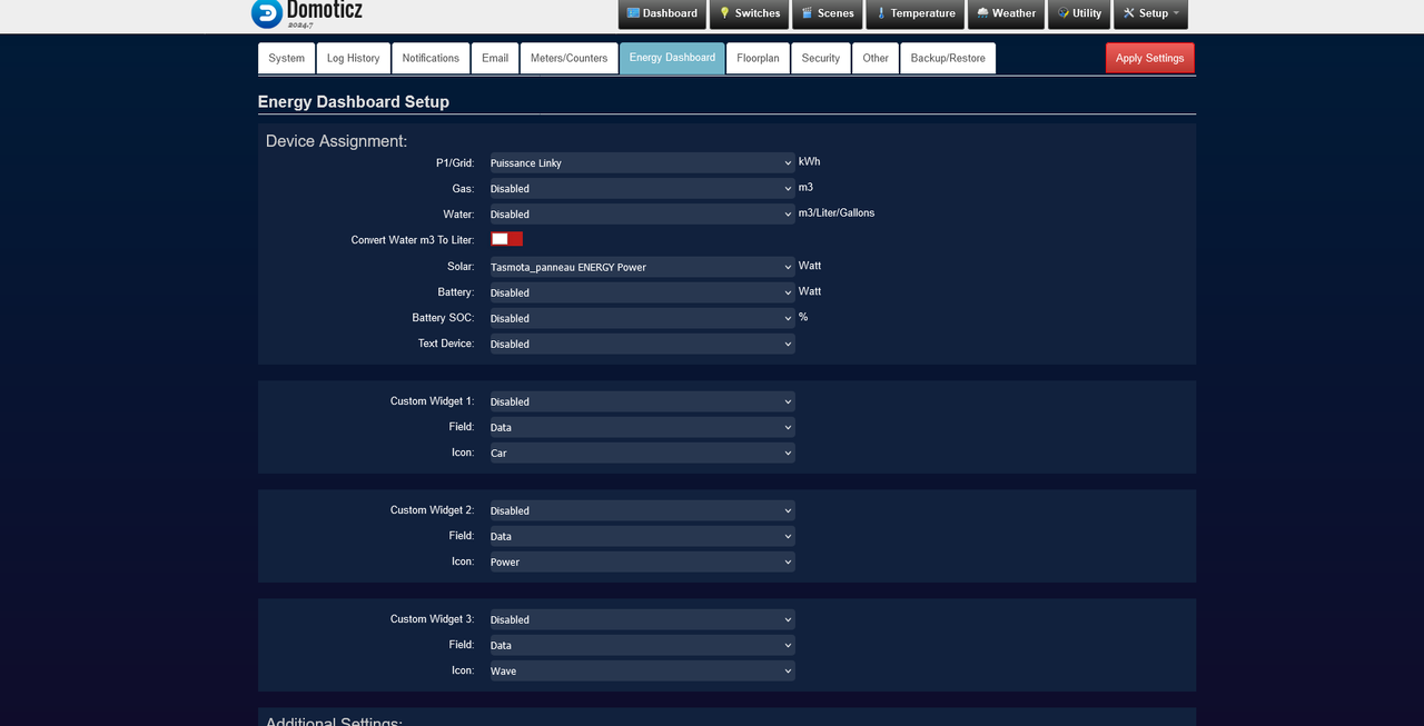

I have configured the energy dashboard as this screenshot :

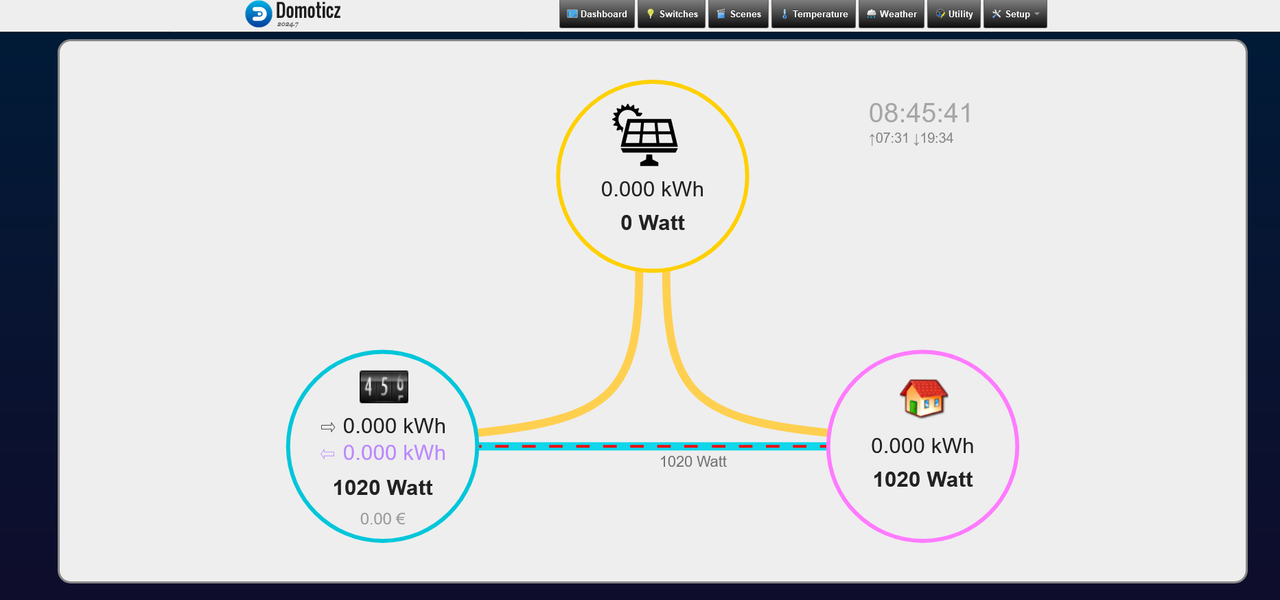

And the result is :
The solar prod stay at 0 despite the fact it is not 0 :

Because you only have Domoticz devices active that show Watt (Power) and no devices that show kWh (Energy). And the Linky device is showing Ampere, so that is completely wrong for the Energy dashboard.
Ideally you should have the combined Energy (kWh) and Power (Watt) devices in your system and use those for the Energy dashboard. Perhaps you have them but not activated?
