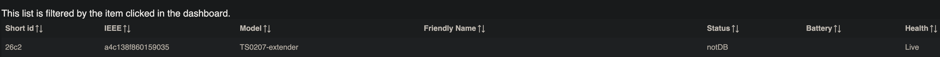

I tried several times with the same results. Then I tried to add it to the Dev Z4D just to check if the extender was working fine - and I got the same result - error and the devices is added as "disabled" and "NotDB"
Fine, it might be broken somehow. I have two brand new USB extenders of different type recognized again as "TS0207-extender" And I'm not able to add them in both Z4D - they're added with an error, in "disabled" state and "NotDB".

This is from the Z4D log:
2024-09-02 12:59:16,609 WARNING :Executing <Handle SerialTransport._read_ready() created at /usr/lib/python3.9/asyncio/selector_events.py:259> took 1.009 seconds
2024-09-02 12:59:17,643 INFO    :b'--> Adding device 26c2 in self.DevicesInPairingMode'
2024-09-02 12:59:17,644 INFO    :b"--> ['26c2']"
2024-09-02 12:59:17,645 INFO    :b'[None] NEW OBJECT: 26c2 None'
2024-09-02 12:59:17,646 INFO    :b'ReadAttributeRequest_0000_for_tuya 26c2'
2024-09-02 12:59:18,642 WARNING :Executing <Task finished name='Task-3024' coro=<ControllerApplication.on_zdo_message() done, defined at /usr/local/lib/python3.9/dist-packages/zigpy_znp/zigbee/application.py:425> result=None created at /usr/lib/python3.9/asyncio/tasks.py:361> took 2.016 seconds
I tried restarting the Z4D plugin, Domoticz, the Dev Raspi, the Zigbee dongle - same results.
Am I missing something or the extenders are just not compatible/working?
Thank you!

Thank you a lot!

This looks strange as there is no issue in this pairing.

I deleted the plugin folder on the test env and cloned in again from GitHub. Started a brand new network and tried to add the first problematic extender (I have 2 of that same kind working in the prod setup). Here is the log with pairing and zclClusters enabled:

Pulled again and now I have the symptoms of the brand new extenders (just a Unexpected error in Domoticz) and here's the log (there are two warning in the end of the log):

Conf/Local-Devices folder is empty. There are no devices paired with that coordinator (it is just for tests).
I tried 4 times to add that exact extender after updating devices DB to 5.307 (restarted Domoticz twice during the tests) and I'm getting the same old results - extender is not added correctly (like the two new ones).
Here is the log from Domoticz:
The extender state in the UI:
Here is the Z4D log from one of the pairs:

2024-09-03 09:45:44,235 WARNING :Unknown device AddrModeAddress(addr_mode=<AddrMode.NWK: 2>, address=0xD07A)
2024-09-03 09:45:44,239 INFO    :b'decode8002_and_process unknown NwkId: d07a for ZCL frame 0180020054ff0001040000010102d07a0200001c3412720a02ff4c0600100121d10b21a8432401000000002106002055a703'
2024-09-03 09:45:44,308 WARNING :Failed to deserialize ZDO packet
  File "/usr/local/lib/python3.9/dist-packages/zigpy_znp/zigbee/application.py", line 473, in on_zdo_message
    zdo_hdr, zdo_args = self._device.zdo.deserialize(
  File "/usr/local/lib/python3.9/dist-packages/zigpy/zdo/__init__.py", line 44, in deserialize
    args, data = t.deserialize(data, param_types)
  File "/usr/local/lib/python3.9/dist-packages/zigpy/types/__init__.py", line 11, in deserialize
    value, data = type_.deserialize(data)
  File "/usr/local/lib/python3.9/dist-packages/zigpy/types/basic.py", line 924, in deserialize
    item, data = cls._item_type.deserialize(data)
  File "/usr/local/lib/python3.9/dist-packages/zigpy/types/basic.py", line 197, in deserialize
    raise ValueError(f"Data is too short to contain {byte_size} bytes")
ValueError: Data is too short to contain 1 bytes
2024-09-03 09:46:15,232 INFO    :b'Z4D closed the Zigbee network'
2024-09-03 09:46:15,264 INFO    :b'++ opening zigbee network for 0 secondes on specific router None'
2024-09-03 09:46:15,309 INFO    :b'Accepting new Hardware: Disable (Off)'
The error reported here is not an issue, it is just that the coordinator and the zigpy layer received a message and was unable to decode it.
