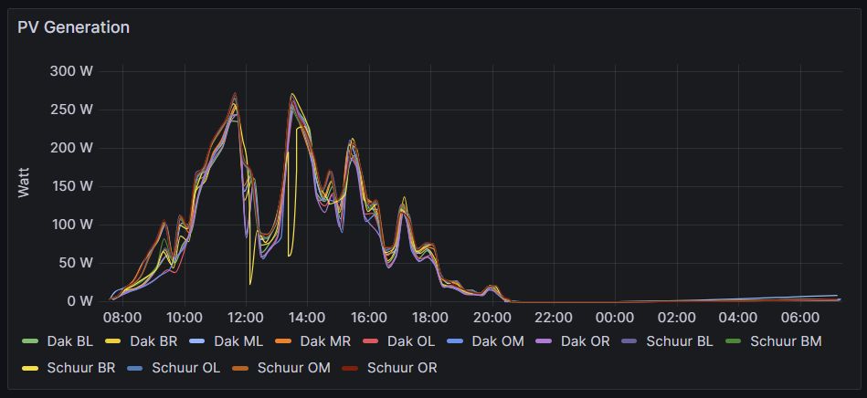

I know this is not a solution for inside Domoticz/dzVents, but you could also use grafana (easy to install with docker-compose and the domoticz mqtt-pusher), and have a graph that looks like this:
You could also let this displayed as a grid/table
