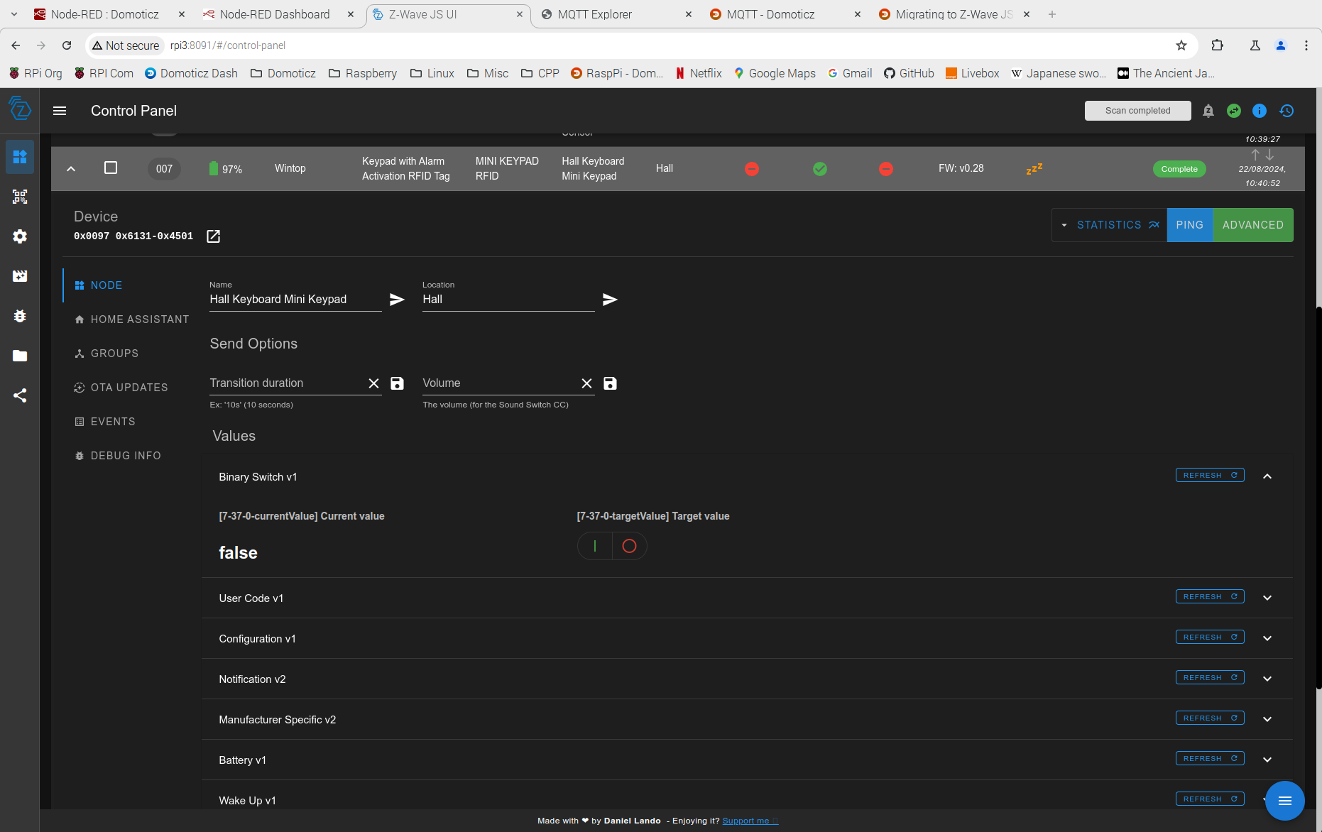

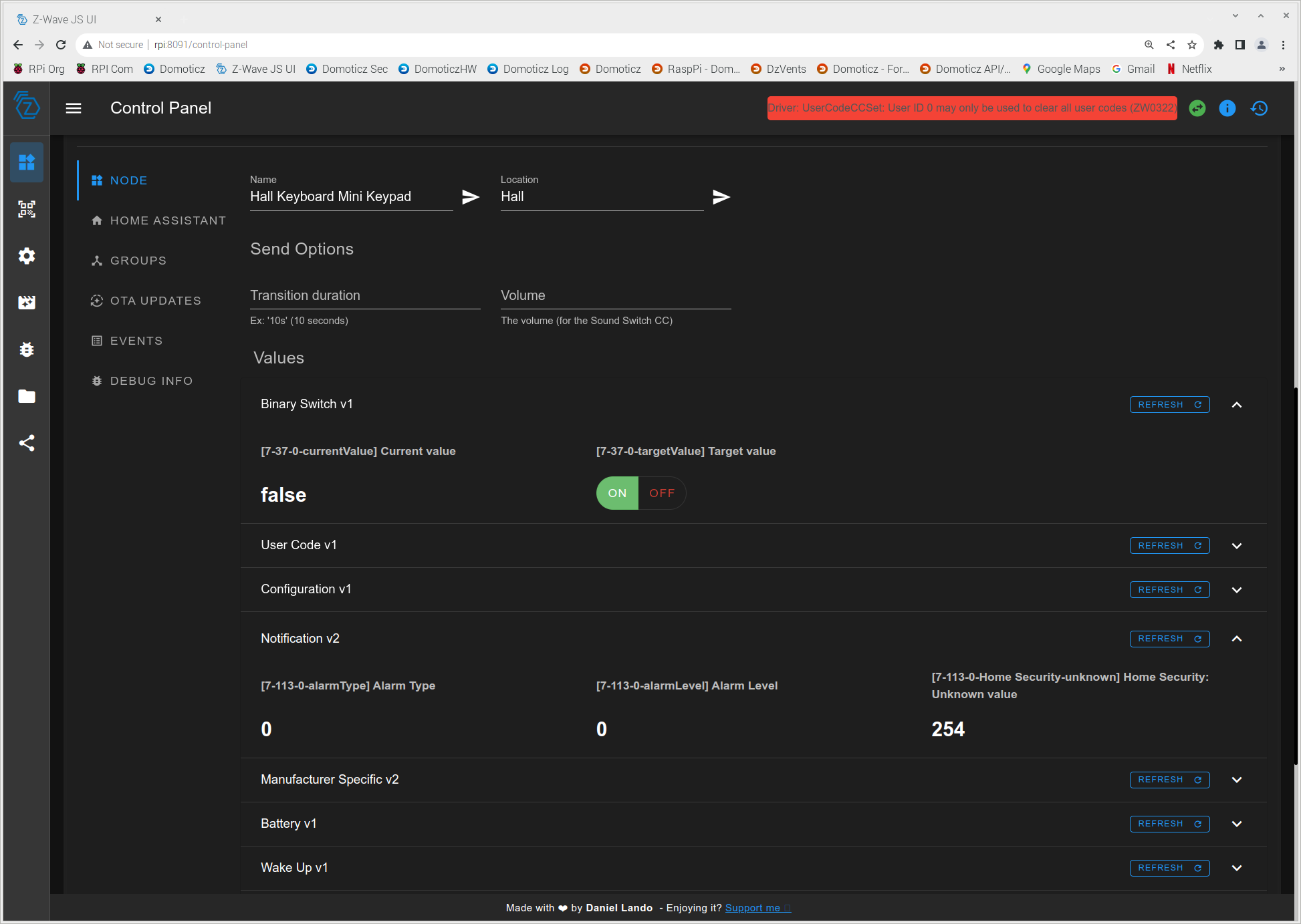

I migrated to Z-Wave JS UI recently and I am encountering some issues with the Zipato Mini Keyboard RFID/Z-Wave node. Mosquitto MQTT Auto Discovery Gateway is enabled and it was able to discover all the node and created node devices. Attached is it’s instruction manual as well as MQTT log files as per script mqtt_ad_record and numerous screenshots.
In the process of verifying all DzVents scripts, noticed that the switch device assigned to Keybord does not receive any data. Manual’s CONTROL section states: “After successful read, the USER_CODE_REPORT or ALARM_REPORT_V2 will be sent.”
Used badged (userId 1) to set Home = Unlock state four time
Used badge (userId 1) to set Away = Locked state three times
Used code (userId 2) to set Home = Unlock state two times
Used code (userId 2) to set Away = Locked state two times

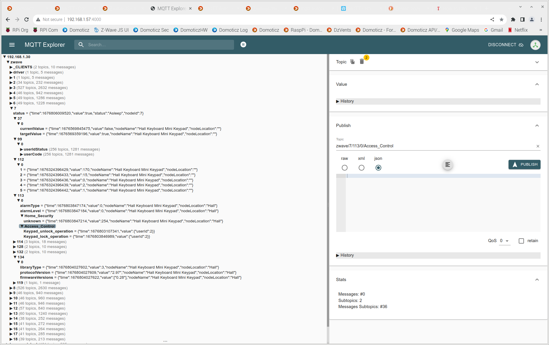

Messages appear in log files and in MQTT Explorer

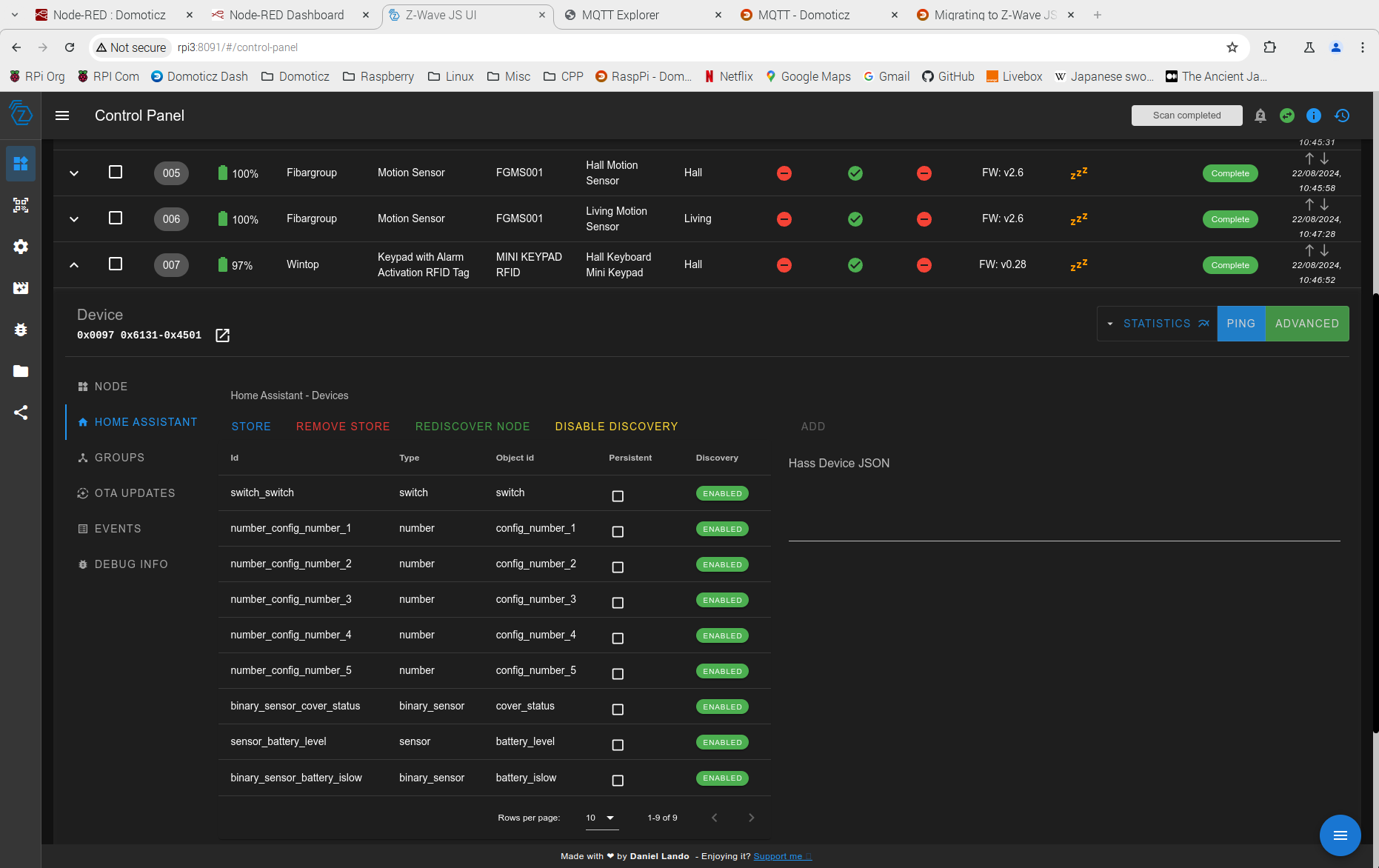

Another community member was asking about a Benext Tag Reader node device which was not “discovered” automatically.
Is there a possibility to add manually a device? :?:
MQTT Explorer Partial Payload
▼113
▼0
alarmType = {"time":1676803847174,"value":0,"nodeName":"Hall Keyboard Mini Keypad","nodeLocation":"Hall"}
alarmLevel = {"time":1676803847184,"value":0,"nodeName":"Hall Keyboard Mini Keypad","nodeLocation":"Hall"}
▼Home_Security
unknown = {"time":1676803847214,"value":254,"nodeName":"Hall Keyboard Mini Keypad","nodeLocation":"Hall"}
▼Access_Control
Keypad_unlock_operation = {"time":1676803107341,"value":{"userId":2}}
Keypad_lock_operation = {"time":1676803846989,"value":{"userId":2}}
▼114
▼114
▼0
manufacturerId = {"time":1676804027502,"value":151,"nodeName":"Hall Keyboard Mini Keypad","nodeLocation":"Hall"}
productType = {"time":1676804027508,"value":24881,"nodeName":"Hall Keyboard Mini Keypad","nodeLocation":"Hall"}
productId = {"time":1676804027514,"value":17665,"nodeName":"Hall Keyboard Mini Keypad","nodeLocation":"Hall"}
▼114
▼0

I Had the same issue with my Wintop Keypad (whis identical with the Zipato device).
I could not define a switch device with an identical behaviour like before, but I found an even better solution.
I've added three new devices in ZwaveJsUI-HomeAssistand-Section
viewtopic.php?p=301578#p301578
This creates 3 new General-Text-Sensors in Domoticz:
Keypad Lock Operation
Keypad Unlock Operation
Unknow User
The sensors get updated with any Keypad operation and include even the submitted RFID-User-ID's,
which makes it possible to identify Keypad users in Domoticz.
Here are the 3 HASS_Json_Device-Definitions I have used:

With a little tinkering to adapt your JSON calls to those already existing and activating rediscover command, I started to receive updates whenever Home or Away button were activated. I fought with DzVents to get a simple method to set Home or Away State once new text message was received. After trying to extract time stamps from text messages and comparing it to current time stamp without any success, I simply used the device change state to determine which of the two had actually changed. All this a very simple script.
One of my old DzVents scripts used JSON command to change motion detector parameters. I had seen some new JSON calls but because MQTT is new I decided to directly use Mosquitto_sub and Mosquitto_pub commands in combined DzVents/Bash scripts. Thus, I now read battery levels and change parameters directly from nodes.
Which brings me to my next question. Is this new “device" configuration stored in a Z-Wave JS UI configuration file/directory or must it be rewritten after each rebooting. Since MQTT is a new beastie, at least for me, I probably misunderstood a posting where is was said to send feedback to integrate new nodes devices where auto discovery had missed node attributes. Now, each node now has a myriad of devices. What happens to this Customization when there is a new version of either Domoticz or Z-Wave JS UI? :D

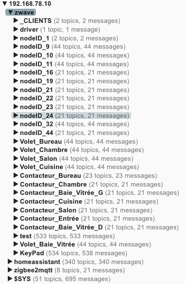

I don't understand how to add a new configuration in Zwave JS UI/control panel/home assistant.
The node 50 has been added
Capture d’écran 2024-07-31 à 20.27.16.png (16.87 KiB) Viewed 5849 times
but in MQTT explorer I see only
Capture d’écran 2024-07-31 à 20.23.31.png (83.7 KiB) Viewed 5849 times
is it normal if I don't see nodeID_50 but only KeyPad?
do I miss something?
thanks a lot for help
Fred

Hello Dartflag,
I saw your message and will get back to you soon. There are still a few things to do before going back to work.
Can you post messages from MQTT explorer under KeyPad topic. It strange that you do not have Node50.
Regards,
ElZorro

I must confess that I only adapted cbartetzko’s commands as per his post. Verify node id which in your case is 50 and configuration Z-WaveJS UI/Settings/Gateway/Topic Names/Named Topics
https://www.domoticz.com/forum/viewtopi ... 78#p301578
Then you need to add devices in the Keypad home assistant page via Z-WaveJS UI with Hass Device JSON. Add one sensor at a time. Clear previous sensor before adding the next one.
Hall Keyboard Configuration
Away Sensor
  "type": "sensor",
  "object_id": "notification_access_control_Keypad_lock_operation",
  "discovery_payload": {
    "state_topic": "zwave/Hall_Keyboard_Mini_Keypad/notification/endpoint_0/Access_Control/Keypad_lock_operation",
    "json_attributes_topic": "zwave/Hall_Keyboard_Mini_Keypad/notification/endpoint_0/Access_Control/Keypad_lock_operation",
    "device": {
      "identifiers": [
        "zwavejs2mqtt_0xdd698388_node7"
      "manufacturer": "Wintop",
      "model": "Keypad with alarm activation rfid tag (MINI KEYPAD RFID)",
      "name": "Hall Keyboard Mini Keypad",
      "sw_version": "0.28"
    "name": "Hall Keyboard Mini Keypad_notification_access_control_Keypad_lock_operation",
    "unique_id": "zwavejs2mqtt_0xdd698388_7-113-0-Access_Control-Keypad_lock_operation"
  "discoveryTopic": "sensor/Hall_Keyboard_Mini_Keypad/notification_access_control_Keypad_lock_operation/config",
  "values": [
    "113-0-Access Control-Keypad_lock_operation"
  "persistent": false,
  "ignoreDiscovery": false,
  "id": "sensor_notification_access_control_Keypad_lock_operation"
Home Sensor
  "type": "sensor",
  "object_id": "notification_access_control_Keypad_unlock_operation",
    "state_topic": "zwave/Hall_Keyboard_Mini_Keypad/notification/endpoint_0/Access_Control/Keypad_unlock_operation",
    "json_attributes_topic": "zwave/Hall_Keyboard_Mini_Keypad/notification/endpoint_0/Access_Control/Keypad_unlock_operation",
    "device": {
      "identifiers": [
    "name": "Hall Keyboard Mini Keypad_notification_access_control_Keypad_unlock_operation",
    "unique_id": "zwavejs2mqtt_0xdd698388_7-113-0-Access_Control-Keypad_unlock_operation"
  "discoveryTopic": "sensor/Hall_Keyboard_Mini_Keypad/notification_access_control_Keypad_unlock_operation/config",
  "values": [
    "113-0-Access Control-Keypad_unlock_operation"
  "id": "sensor_notification_access_control_Keypad_unlock_operation"
User
  "type": "sensor",
  "object_id": "notification_Unknown_User",
    "state_topic": "zwave/Hall_Keyboard_Mini_Keypad/user_code/endpoint_0/userCode/0",
    "json_attributes_topic": "zwave/Hall_Keyboard_Mini_Keypad/user_code/endpoint_0/userCode/0",
    "device": {
      "identifiers": [
    "name": "zwave/Hall_Keyboard_Mini_Keypad/user_code/endpoint_0/userCode/0",
    "unique_id": "zwavejs2mqtt_0xdd698388_7_5-99-0-Unknown_User"
  "discoveryTopic": "sensor/Hall_Keyboard_Mini_Keypad/Unknown_User/config",
  "values": [
    "99-0-Unknown_User"
  "id": "sensor_notification_Unknown_User"
