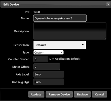

I made a dzvents script to calculate the daily energy costs. I store these costs in dummy sensors. That works fine. I want to store these values in managed counters however. The advantage of managed counters is that you can have reports in the graphs view.
To test if this works I made an extra dummy managed counter.
I write the cost to the sensor at 23:59 hours using the command:
domoticz.devices('Dynamische energiekosten 2').updateCounter(Kostentotaal)
That works fine. I see the following in the devices tab:

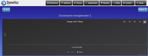

The graph as well as the report remains empty:
I made a backup of the database and opened it in an SQLite viewer. There are no values in the Meter or Meter_Calendar tables.
I searched the forum and the internet, but could not find what I am doing wrong. Who can help?

I do something similar all the time, the updateHistory works fine.
If you want to store a daily value in the meter_calendar table you need to use
domoticz.devices('Dynamische energiekosten 2').updateHistory(valueDate,valueString)
where valueDate is a date in format yyyy-mm-dd
and valueString is a string with 2 values separated by a semicolon.
The first value of valueString will be stored in the counter field (i.e. the cumulative value of all days).
The second value will be stored in the value field.
So you could start with
local valueString="0;"..Kostentotaal
and use that value in the updateHistory command.

Thank you all. It works! I tried it before using the updateHistory command. I probably made a mistake.
I now am going to rewrite the script to write the gas costs, the electricity costs and the total cost to managed counters.
