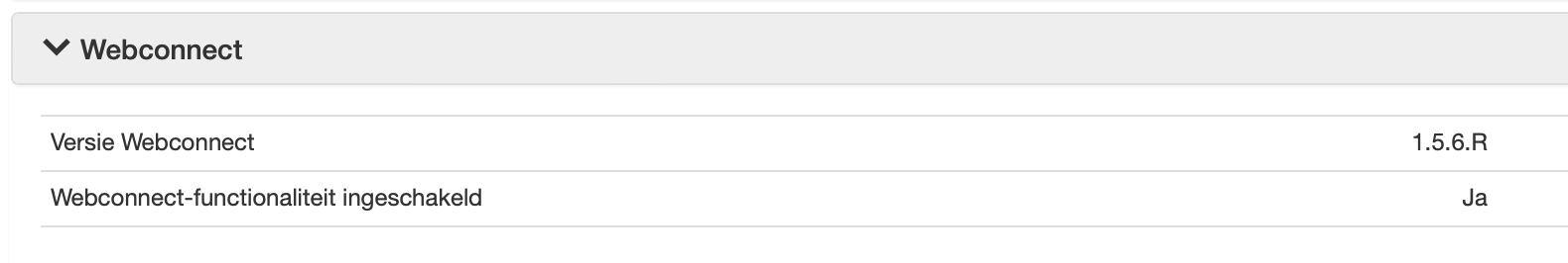

Wait, is web connect active on the SMA?
Scherm­afbeelding 2024-08-17 om 17.06.39.png (27 KiB) Viewed 2320 times

This morning I did the whole installation again, I changed the password to a easier one. Unfortunately I'am getting the same errors again.
And yes the Webconnect is active on both SMA's
