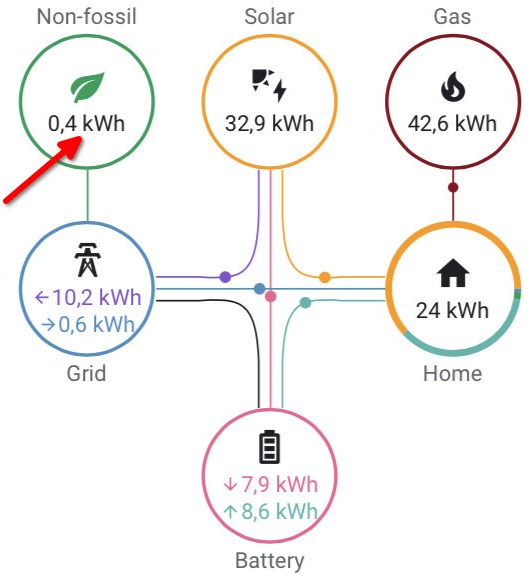

No doubt, that the creators/developers has also seen the Energy dashboard in Home Assistant and probably also at other places.
In HA they have a widget, representing the fossil-free Energy, which is connected to the "Grid" circle.
See picture below.
HA_ Energy_dashboard.png (195.11 KiB) Viewed 2674 times
Unfortunately it is only possible to connect an extra "Text" device, that displays the fossil-free Energy.
Screenshot_Energy dashboard part.png (50.51 KiB) Viewed 2674 times
This information is actually stored in an Electric (Instant + Counter), but cannot be used in the Energy dashboard.
Suggestion: Could this be made possible and connected to the "Grid" circle?

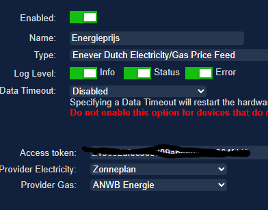

I have a question about the built-in dynamic price calculation. I would like to work with NETTO prices because what you get for your kW's it's without the taxes. It's about 0,15 cent here in the Netherlands. Is there a way to add something to the script and how to accomplish that?
I take the prices from 'Zonneplan' from the Enever feed. Thank you!

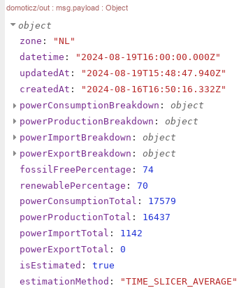

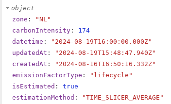

I take the data form this website: https://app.electricitymaps.com
This site is open-source and has a free API. You need an API key, but you can use it for free.
It will give you in fact the origin of the electricity, that you consume from the grid, as well as the Carbon footprint
and
In the second picture you will see the fossilFreePercentage for a specific area.
The site supports over 200 areas. Smaller countries, like The Netherlands or Belgium are one area each, while the real big countries have multiple areas.
I assume that the energy, I consume from the grid, consists of that percentage of fossil-free energy.
Therefore I take the power from the grid and multiply it with the percentage. Next I calculate the energy.
So the MQTT value from the P1 device is sent to (in my case) Node-RED (svalue5), multiply it with the percentage and calculate the energy.
This value is returned in a "Text" sensor.
I first created an "Electricity (Instant + Counter) sensor and let Domoticz do the "Energy" calculation, but unfortunately I could not make that sensor visible in the "Energy Dashboard". Therefore I changed it to a "Text" sensor.
I'm not sure, whether it is better to use the fossilFreePercentage or the renewablePercentage. I took for now the HASS presentation
The difference is that fossilFreePercentage includes the nuclear energy and the renewablePercentage is without the nuclear component.
The Node-RED flow I posted at: https://www.domoticz.com/forum/viewtopic.php?t=42587
