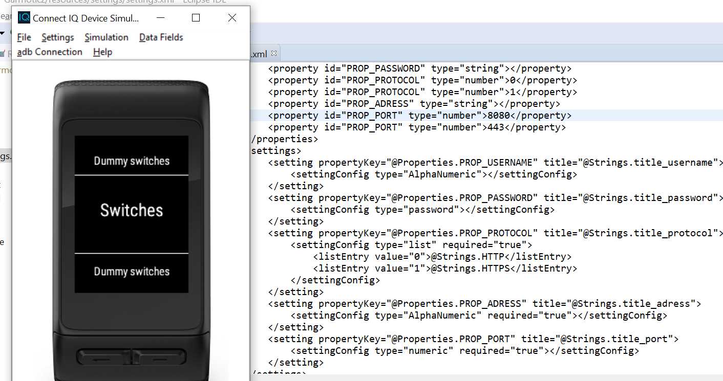

In the simulator it works. First it did not (https needed-error, unticked "use device https requirements", now it works. See screenshot (I have 2 rooms: Switches and Dummy Switches, this is obslete, still have to change that.)
What I noticed also:
- When sideloading the app to my Vivoactive, I don't get a completed-messege or something like that. It also seems to stop halfway the progress bar. I do not know if this is normal behaviour?
- I cannot change the settings of the widget in the connect IQ app. It simply does not display a settings-button (only remove and look up in store buttons).
I also did an reset (system > restore defaults) on my watch, not helping....

unfortunately yes. The garmin tools don't have a well design Customer Journey..Geitje wrote: Saturday 07 December 2019 20:47 - When sideloading the app to my Vivoactive, I don't get a completed-messege or something like that. It also seems to stop halfway the progress bar. I do not know if this is normal behaviour?
that's also normal behaviour (and another example of bad customer journey in dev tools by garmin). As stated above. This is how i change settings on a side loaded app:Geitje wrote: Saturday 07 December 2019 20:47 - I cannot change the settings of the widget in the connect IQ app. It simply does not display a settings-button (only remove and look up in store buttons).
- use the instructions to run the app with the simulator. Use your own device model in the simulator ofcourse.
- in eclipse use the settings editor to create the settings file in the simulator
- then copy the settings file from C:\Users\[username]\AppData\Local\Temp\GARMIN\APPS\SETTINGS to the settings map on your device (and make sure is has the same name as the app)
If the same settings file in the simulator makes the app run ok, but with a downgraded garmin connect app on a real devices causes error -300, then i think this workaround also no longer works (cause this was the original error) and using https is then the only option....

I tried this 3 times, and last one succeeded! (do not know why copying did not succeed at first...)
Now it is working, even with GCM 4.19.1. Finally
Thanks for your support @akamming!
