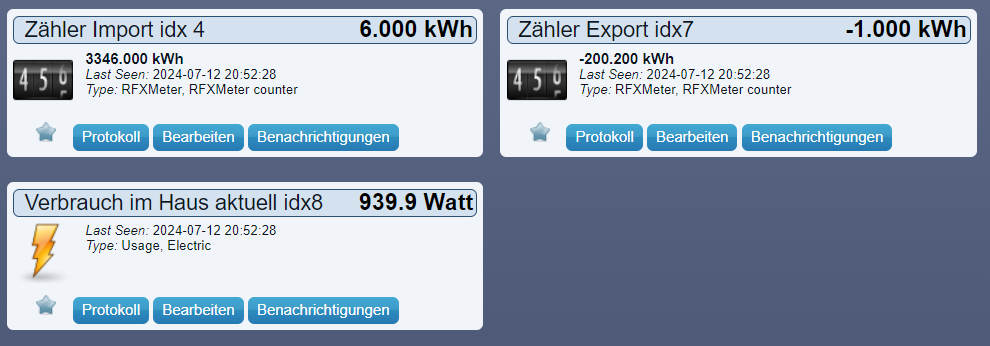

I have a “Hichi IR reading head” (Tasmota) attached to my electricity meter. Today I have three devices as shown in the Screenshot. All other Tasmota idx numbers are sending nothing.
Now I want to merge everything to use it in the (phantastic) new Energy Dashboard - but how?
Thanks in advance for any hint.

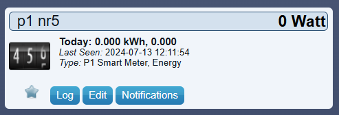

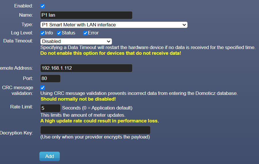

I have added the hardware "P1 Smart Meter with LAN interface" with the IP-adresse of the tasmota IR reading head and Port 80 (8080 like shown in the wiki gives an error in the logfile) - Screenshot attached
Then I have created the dummy P1 device and it looks OK (still with zero values of course) - Screenshot attached
But the following error occurs:
Error: GetJSonDevices: exception occurred : 'stoull'
When I then activate the script (I only replaced the idx numbers, see code), Domoticz is freezed.
I have to restart Domoticz via SSH terminal and quickly deactivate the script in Domoticz to avoid further freezing. The dummy P1 device then has a reduced appearance - Screenshot attached.
And after the restart of Domoticz, a new error occurs (every 5 minutes):
Error: UpdateMultiMeter: Error converting sValue values! (IDX: 448, sValue: 'nil;0;nil;0;502.6;0', dType: 250, sType: 1)
Sorry that I can only provide this amateurish information... Any idea?

The P1 hardware gateway is not needed you can remove it. It will automatically remove the associated P1 device. You only need the dummy P1 device.
Also make sure you fill in the correct device IDX numbers.

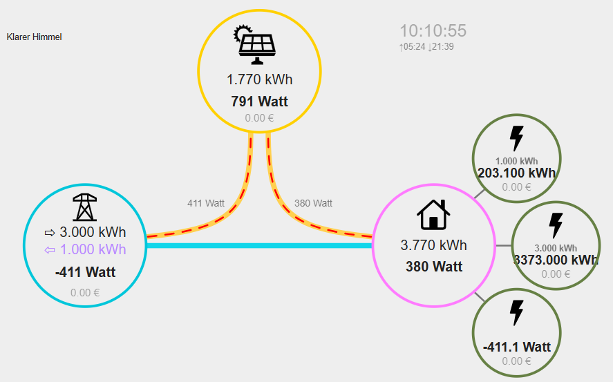

But ".counter" gives (at least in my case) the total meter reading that has ever been measured since the meter was installed by the electricity supply company. Without any relation to a certain period of time. So ".counterTody" works here. Will watch what happes at midnight.
Maybe the basic data from my Domoticz counters that are fed by the Tasmota infrared reading head are different from the normal standard of P1 ...
According to multiplication by 1000: In the general setting for meters/counters I have to set a divider of 1000, otherwise the kWh figure of the house item in the energy dashboard is weird.
Everything seems to be a little bit confused in my system ...
