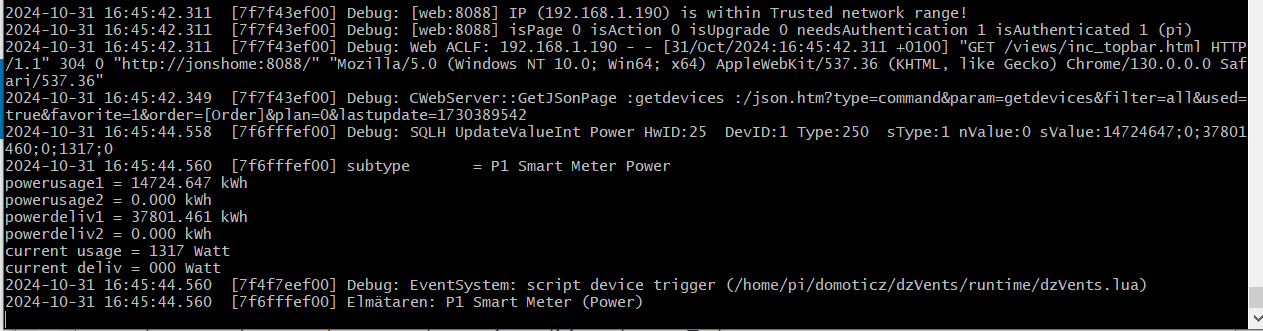

I have the same problem and been struggling with this for many hour.
My setup is a new RP4, latest OS, latest domotics, docker and installed as per instructions.
A MyZwave gpio-card, moved from my old RP3, database backup from RP3 installed on the new RP4.
MQTT seems to work, JSUI seems to work.
I have enabled log and debug, all except sql, alot coming in and it seems to work OK. (root@jonshome:/opt/mosquitto# /home/pi/domoticz/domoticz -nowwwpwd -daemon -www 8088 -log /var/log/domoticz.log -loglevel all -debuglevel normal,hardware,received,webserver,eventsystem,python,thread_id,auth
When I start a browser and f.i. go to http://jonshome:8088/ domotics die and the last lines in the log contains: The latest thing I tested was to remove the Zwave card, but that didn't help.
Before that I uninstalled docker and the 2 containers.
I have tested Edge and Chrome in windows and chrome on android, all of them crashes domoticz. Well crashes, the crashlog is empty, domoticz just dies..
I'm out of ideas now, hopefully some of you guys can help out.
