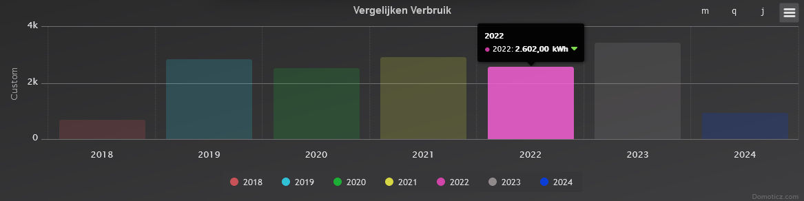

Is it possible to show an extra chart, for both P1 gas and electricity charts, just showing the total year usage per year?
When choosing a new energy supplier, for price comparison, I have to submit the gas and electricity on yearly basis. Now I have to add up all 12 month manually...
And it will also be nice to see if any energy saving measures take effect over years.

Why in a chart? Just go to the P1 Electricity report page or the P1 Gas report page (device Log -> Report) and you see everyting per year.....Hansbit wrote: Thursday 13 June 2024 17:41 Is it possible to show an extra chart, for both P1 gas and electricity charts, just showing the total year usage per year?
https://www.domoticz.com/wiki/Managing_ ... ice_Report
You can also set the compare chart (last chart) to year display and it will show the logged results per year (and not default by month).

Found it! Overlooked clicking on 'y' for years. Thanks!!waltervl wrote: Thursday 13 June 2024 23:41
