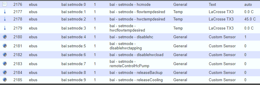

I don't understand which device is writable.
Can show me one node from json and which parameter indicates this?

Post by fantom »
So I understood correctly from the code.
In my json i have only two nodes with write = true and zero with "-w".
But in domoticz i have many of devices for write. For exammpel setpoints and selectors.
And all devices for write, i have like "read only".
   "SetMode": {
    "name": "SetMode",
    "passive": true,
    "write": true,
    "lastup": 1715512253,
    "zz": 8,
    "id": [181, 16, 0],
    "fields": {
     "hcmode": {"value": "auto"},
     "flowtempdesired": {"value": 0.0},
     "hwctempdesired": {"value": 45.0},
     "hwcflowtempdesired": {"value": null},
     "disablehc": {"value": 1},
     "disablehwctapping": {"value": 0},
     "disablehwcload": {"value": 0},
     "remoteControlHcPump": {"value": 0},
     "releaseBackup": {"value": 0},
     "releaseCooling": {"value": 0}
    "fielddefs": [
     { "name": "hcmode", "slave": false, "type": "UCH", "isbits": false, "length": 1, "values": { "0": "auto", "1": "off", "2": "water" }, "unit": "", "comment": "boiler mode"},
     { "name": "flowtempdesired", "slave": false, "type": "D1C", "isbits": false, "length": 1, "unit": "°C", "comment": "temperature"},
     { "name": "hwctempdesired", "slave": false, "type": "D1C", "isbits": false, "length": 1, "unit": "°C", "comment": "temperature"},
     { "name": "hwcflowtempdesired", "slave": false, "type": "UCH", "isbits": false, "length": 1, "unit": "°C", "comment": "temperature"},
     { "name": "", "slave": false, "type": "IGN", "isbits": false, "length": 1, "unit": "", "comment": ""},
     { "name": "disablehc", "slave": false, "type": "BI0", "isbits": true, "length": 1, "unit": "", "comment": ""},
     { "name": "disablehwctapping", "slave": false, "type": "BI1", "isbits": true, "length": 1, "unit": "", "comment": ""},
     { "name": "disablehwcload", "slave": false, "type": "BI2", "isbits": true, "length": 1, "unit": "", "comment": ""},
     { "name": "remoteControlHcPump", "slave": false, "type": "BI0", "isbits": true, "length": 1, "unit": "", "comment": ""},
     { "name": "releaseBackup", "slave": false, "type": "BI1", "isbits": true, "length": 1, "unit": "", "comment": ""},
     { "name": "releaseCooling", "slave": false, "type": "BI2", "isbits": true, "length": 1, "unit": "", "comment": ""}
   "StatusCirPump": {
    "name": "StatusCirPump",
    "passive": true,
    "write": true,
    "lastup": 1715512240,
    "zz": 8,
    "id": [181, 18, 0],
    "fields": {
     "0": {"name": "", "value": "on"}
    "fielddefs": [
     { "name": "", "slave": false, "type": "UCH", "isbits": false, "length": 1, "values": { "0": "off", "100": "on" }, "unit": "", "comment": ""}
Barberousse
Posts: 141
Joined: Wednesday 02 December 2015 21:47
Location: France
Re: Python Plugin: ebusd
Post by Barberousse »
fantom wrote: Sunday 12 May 2024 13:14 So I understood correctly from the code.
Are you reading your json with write get parameter, for instance http://domotique:8889/data?def&write ? Otherwise (http://domotique:8889/data?def or http://domotique:8889/data) the messages ending with "-w" won't show up.
Be aware that starting version 2 of the plugin, I used the new extended plugin framework (because it allows unlimited number of devices, it's handy to manage auto discovery). But there is a bug, I created a PR here https://github.com/domoticz/domoticz/pull/6079 . For now, if the devices have been created with the plugin parameter read-only enabled, the plugin won't be able to change the device type to the read/write counterpart if you change the read-only parameter of the plugin, and vice-versa. In last versions of the plugin, you will have an error message asking you to delete such devices, it will be created on next launch of plugin (restarting Domoticz, or choosing "Modify" in plugin parameters).
For me StatusCirPump should be with write to false, I don't know why it is set to true.

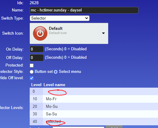

But 0 equal "selected" (in domoricz 0 = "empty")
And 40 should be empty.

fantom wrote: Thursday 06 June 2024 20:25 But 0 equal "selected" (in domoricz 0 = "empty")
Levels in domoticz are not the same as index in Json. But I agree on one point, the sorting is not correct. It's fixed in version 2.1.6. Affected devices should be deleted, then restart Domoticz or got in the plugin parameter and press "Modify" to redetect the devices.
