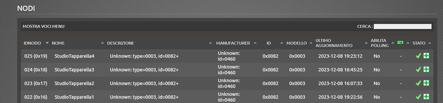

Hi guys,
I've just installed 4 Shelly Qubino Wave Shutter modules to control my blinds.
While I've been able to use them to open and close my blinds (fully open or fully close only for now), it seems they're not fully supported, there's no configuration.
Did anyone know something more about this please?
Thanks,
mantoz

OK, some more investigations and a reply to myself as this could be helpful to some other user.
OpenZWave is not maintained anymore, so new devices are not added to the device database anymore (and SW development has stopped, I think, what a pity!).
However, as all devices need to be compliant to ZWave specs, basic features work out-of-the-box and just a config file is needed to have some additional features.
So I added the following lines to domoticz/Config/manufacturer_specific.xml file to make OpenZWave recognize the new Shelly/Qubino Wave Shutter devices:
<Manufacturer id="0460" name="Shelly Qubino">
	<Product config="shellyqubino/waveshutter.xml" id="0082" name="Wave Shutter" type="0003"/>
</Manufacturer>
Then I created an additional config file named domoticz/Config/shellyqubino/waveshutter.xml to add some additional info:
<?xml version="1.0" encoding="utf-8"?>
<Product xmlns='https://github.com/OpenZWave/open-zwave' Revision="2">
<!-- ShellyQubino: Wave shutter -->
	<!-- Configuration  -->
	<CommandClass id="112">
		<Value type="list" genre="config" instance="1" index="71" label="Operating modes" size="1" min="0" max="1" value="0">
			<Help>This parameter defines selection between two operating modes. NOTE: After setting a mode the module needs to be reconfigured. Please check the detailed description in the product manual.</Help>
			<Item label="Shutter mode" value="0" />
			<Item label="Venetian mode" value="1" />
		</Value>
		<Value type="list" genre="config" instance="1" index="78" label="Forced Shutter calibration" size="1" min="0" max="1" value="0">
			<Help>By modifying the parameters setting from 0 to 1 a Shutter enters the calibration mode. Once the calibration process finished the parameter reports a result value: 2: device calibrated, 3 device not calibrated, 4 calibration error</Help>
			<Item label="Default" value="0" />
			<Item label="Start calibration process" value="1" />
		</Value>
	</CommandClass>
	<!-- Association Groups -->
	<CommandClass id="133">
		<Associations num_groups="2">
			<Group index="1" max_associations="16" label="Multilevel" auto="false"/>
			<Group index="2" max_associations="1" label="Lifeline" auto="true"/>
		</Associations>
	</CommandClass>
	<!-- Remove COMMAND_CLASS_BASIC -->
	<CommandClass id="32" action="remove" />
</Product>
After restarting OpenZWave/Domoticz, the new Shelly/Qubino devices are correctly identified. If you don't have the additional info specified in waveshutter.xml, just try refreshing the node in the node list of your ZWave controller.
Just an additional note, you probably need to perform a calibration of the Shelly Qubino Wave Shutter after installing it for the first time to have it working with percentage open/close commands. You can perform it through on the specific node menu.
