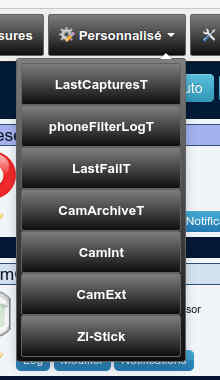

Thanks for testing, but on my side (+v2024.4/Stable) this is not the case:
EDIT: You're observation anyway rings a bell.
First 4 menu items links to some auto-gen'ed pages (from python services of my own that starts after Domoticz as they need it's HTTP/JSON API being up & check for this/delay startup: This may make a difference, but, in my case should IMO not be the case, see hereafter).
Last 3 are html files that never change + Zigbee4Domoticz, so a python plugin Domoticz is aware off.

Tried to restart, but ordering unchanged... In fact, looks anything that was present in my last year full reinstall was ordered alphabetically at this time/once, then anything added since then got ordered by time of addition: Z4D was for instance last addition in early February (starting with my 1st zigbee devices), but looks ordering had nothing to do with ZiStick starting by "Z" in hereupper capture: I did a test one of my page name between another domoticz service stop and start, this one is now last position in menu starting by letter "C".
That's no big issue, but I can't see any way of enforcing an order there on an existing setup.
