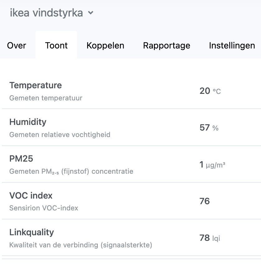

Z2M reports
Screenshot 2024-04-21 at 13.15.47.png (87.95 KiB) Viewed 3397 times
How can I make domoticz add the PM25 and the VOC index sensors ???

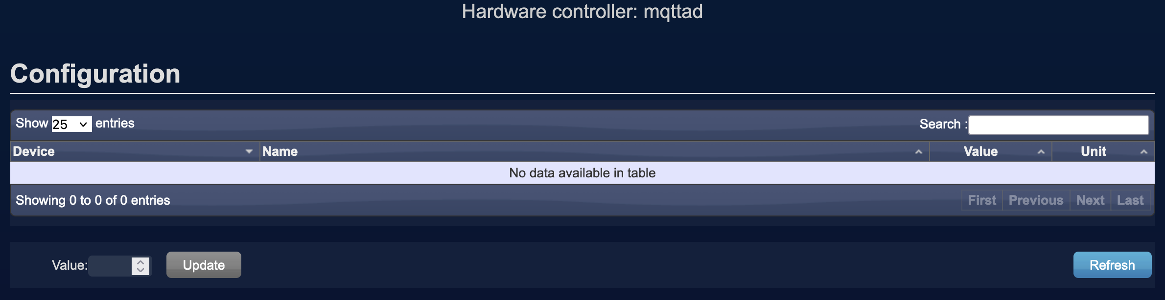

by pushing the SETUP button on this screen
Screenshot 2024-04-22 at 15.24.43.png (27.04 KiB) Viewed 3297 times
I get the next screen
Screenshot 2024-04-22 at 15.24.59.png (121.19 KiB) Viewed 3297 times
which is empty ...
Is this normal ???

Posts: 6683
Domoticz version: 2025.1
Re: Ikea Vindstyrka E2112 PM25 and VOC index sensors not created on Zigbee2MQTT plugin
Yes, this is normal, there only mqtt ad number devices are shown to set other zigbee devices.
The normal devices will be shown in the default device list (menu setup - devices) as you are used to also with the plugin.
https://www.domoticz.com/wiki/Setup_Devices
gizmocuz
Posts: 2709
Location: Top of the world
Post by gizmocuz »
Number devices are used by nodes for some settings. (Like a temperature offset)
But most things can just be configured in Zigbee2MQTT via it's web interface
