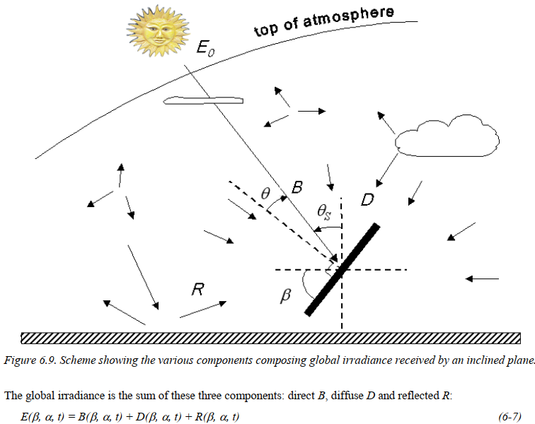

The luminance given in the original script is considered on the floor (horizontal projection of the sun radiation or measured on an horizontal surface).
For a window, vertical or on a roof, what is needed is the projection of the luminance on the normal of the considered surface.
As the luminance given by the script is the sum of the direct and the scattered luminance, it is not possible to apply the projection, because the scattered luminance is a any direction.
That's why I propose a new version of this script, that gives separate values for direct and scattered luminances, so that we could calculate the right value on a surface with any slope.

    19/08/2021 - hestia - add several radiation devices to have direct and scattered, with (weighted) or w/o cloud impact radiation separate, in order to calcultate the radiation on a surface with any angle from the ground.
    The result given previously for the radiation was on the ground only, so not usable for a window (vertical) or a roof (w an angle).
    Change the formula of the coefficient of mitigation M, to avoid the requirement of the pressure (no longer needed this weather info: more simple)

I also have a device with "Sunpower" value in Watt/m2 from a nearby weatherstation, which I assume is the Direct Normal Irradiance DNI, measured on a surface perpendicular to the sun beam, and therefore already incorporating cloud cover effect. Using your sun altitude and azimuth calculation and the angle and azimuth of my PV installation, I can easily calculate the beam irradiance.
If your info is from a weather station, from what I saw on the doc of some of them, the sensor in horizontal, so it is not the direct normal radiance, but the full radiance on a horizontal area.
You could not calculate the beam radiation from a radiation given by a weatherstation because
The full radiation is the addition of: direct B, diffuse D and reflected R (I kept the "scattered" term for diffuse) and only B and R are in "one" direction. So you could not make a projection on the D ; and the B and R do not have the same angle from the area
https://hal-mines-paristech.archives-ou ... ald_v1.pdf
Screenshot 2022-06-22 224002.png (89.76 KiB) Viewed 4688 times
In that formula I don't see
GHI (global horizontal irradiance)
DHI (diffuse horizontal irradiance)
As I think they are calculated values from a formula regarding a specific application of your web site.
Regarding your objective
theoretical performance of my PVpanel installation and to then compare this to actual performance
you could have a look at this script
blinds move on the sun
There is a function GetSunRadiation that could give the radiation on an area of a sun panel (if you keep this formula)
math.max(_u.round(F_solarRadiation * F_cosIncidence + F_solarRadiationScattered, 0), 0)
