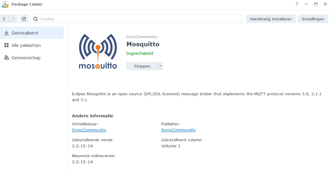

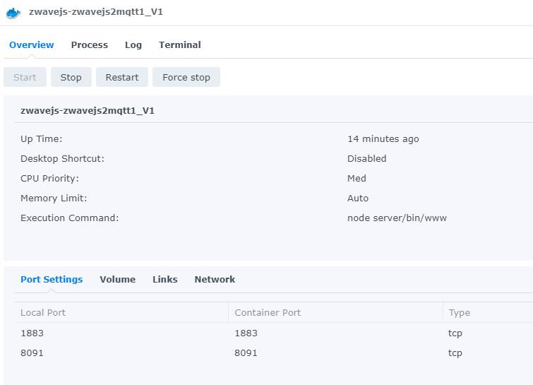

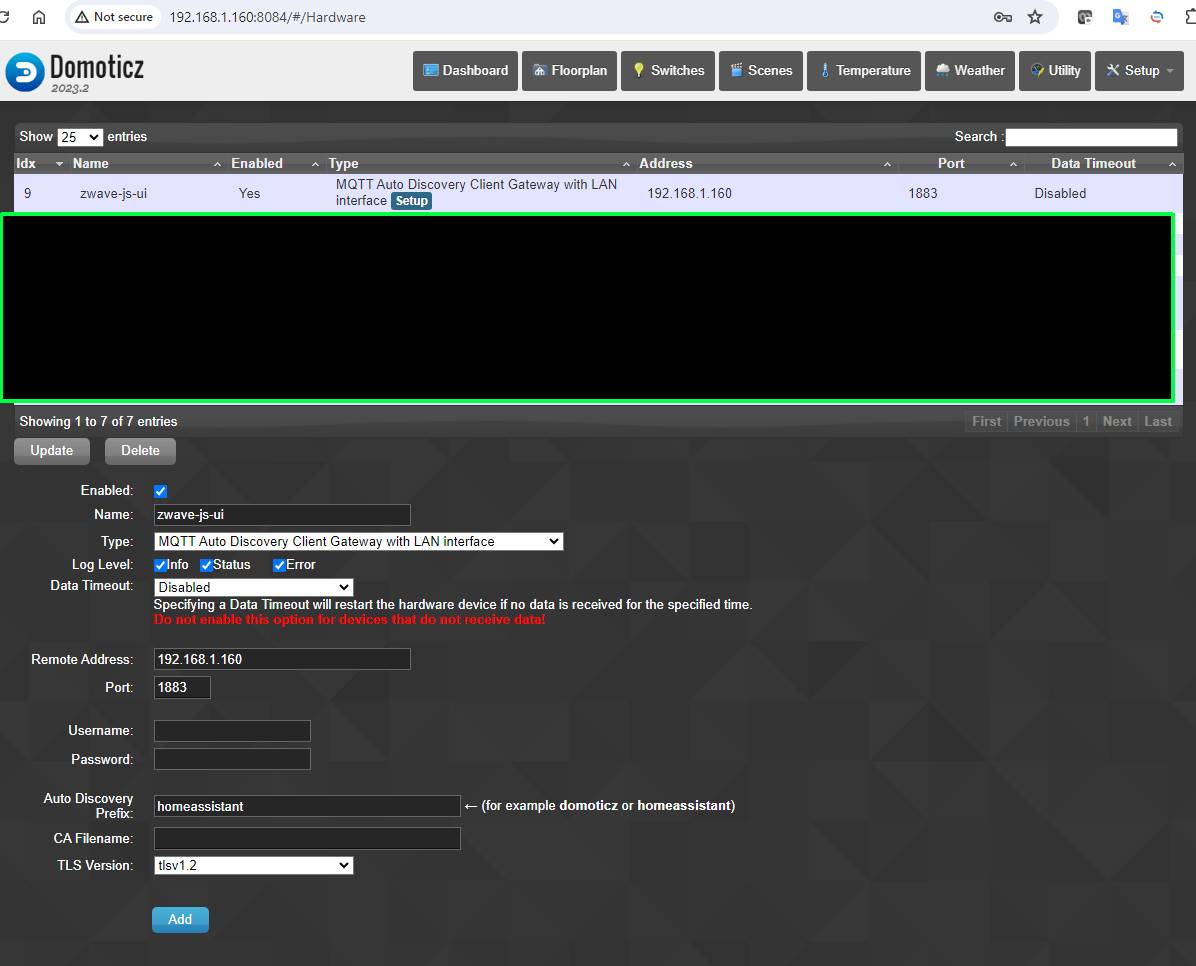

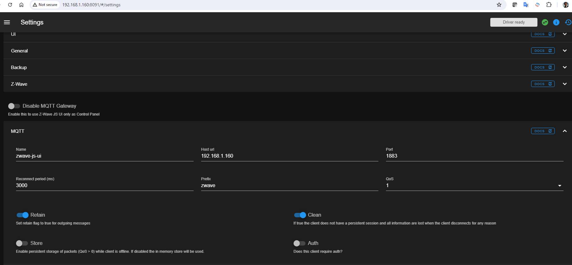

Dear all,
I have a big problem to detect my ZWave device from the MQTT server on my Domoticz both are in docker in my synology NAS :
Step 1) I install on a docker image zwavejs2mqtt1 correctly and it's look to detect all my zwave device, nice. I try to configure MQTT like that Image1
Step 2) I also install correctly image Domoticz V2023.2 and add hardware "MQTT Auto Discovery Client Gateway with Lan" and setup it like the image 2
But... Domoticz don't discover into hardware "MQTT Auto Discovery Client Gateway with Lan" (setup button) any zwave devices view into zwavejs2mqtt1 image... why ? What I have bad setuped ?
Best regards
Best regards

May be a question of IP addresses. Check that the 2 containers are on the same docker network. See https://www.tutorialworks.com/container-networking/. The IP used by the container is given byfunmsa wrote: Tuesday 02 July 2024 1:17 Dear all,
Best regards

Dear all,
@akamming : I'm sorry but I use Docker package on my Synology, I don't use direct command line "compose" or other. I'm not sure it's the problem
@mgugu : I can from my LAN network access web page ZWave-JS-UI and see all zwave devices so... why from docker of my Domoticz, I can access the URL port 1883 ???
About IP address I do the grep and obtain this
root@diskstation2:~# docker inspect zwavejs-zwavejs2mqtt1_V1 | grep IPAddress
"SecondaryIPAddresses": null,
"IPAddress": "172.17.0.3",
Docker is setuped and running on network bridge and I open 2 ports
- 8091 to let me access to HTTP server
- 1883 for TLS MQTT.
but despite this when I click on "Setup" of my hardware "MQTT Auto Discovery Client Gateway with Lan" I still do not see the zwaves devices... Does anyone have screenshots of their hardware config "MQTT Auto Discovery Client Gateway with Lan" in the Domoticz docker in order to see how they managed the setup please ?
I have this on Domoticz log :
2024-07-03 00:48:09.804 Status: zwave-js-ui: Connecting to 192.168.1.160:1883
2024-07-03 00:48:09.904 Error: zwave-js-ui: disconnected, restarting (rc=7/The connection was lost.)

You could start easier (to avoid multiple docker issues) and implement Mosquitto as package on Synology. I'm running ZwaveJsUI under Docker (Container Manager) in combination with Mosquitto. And runs fine. Later on you could migrate to MQTT under Docker.funmsa wrote: Saturday 06 July 2024 7:49 Effectevly no, MQTT explorer can open a connexion on port 1883. But After reread perhaps I miss something...

Dear all,
FINALLY is working quiet fine I could correctly setup Mosquitto MQTT Broker and receive all device. The problem was fact than we need setup port for listener 1883 (and let anonymous access to) in MQTT config file mosquitto.conf AND edit the good config file (many was on my Synology and good config file wasn't taked) Without this, only local (into container) could connect to the internal listener...

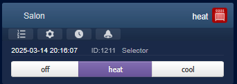

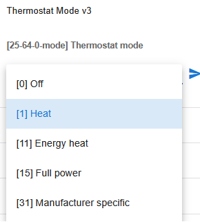

I have a question about thermostatic valves. I use Eurotronics Spirit. On menu ZWave UI in the Thermostat Mode tab there are five options to choose from, as in the picture nr 1. In Domoticz I have only three options, as in the picture nr 2.OFF in UI = OFF in Domo, Heat in UI = Heat in Domo, Energy heat in UI = Cool in Domo. What about the other two options from the UI? Is there any way to make them also displayed in the selector switch in Domoticz?
