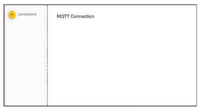

3. For the setting of MQTT Explorer.
Step 1: Open the MQTT Explorer.
Step 2: Click + "Connections"

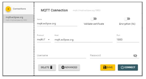

Step 3: Fill out the fields as shown below:
Name: whatever you like
Validate certificate: Off
Encryption: Off
Protocol: mqtt://
Host: The IP Address of your Mosquitto device
Port: 1883
Press "Connect".
