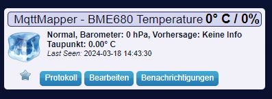

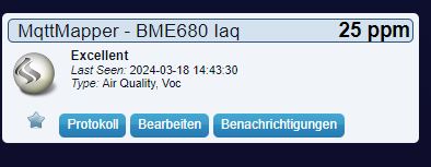

Thanks for your reply. I have used your json file from above and got the follwing result. Not really what I exprected because Temperature and Barometer values passed away and Hunidity stay 0. I intend to get four devices in domoticz for temperatur/pressure/humidity/iaq ... if possible. The remaining values like CO2, Iaq accuracy and VOC will follow later on when I understand how to configure the json file

The way it is setup, there's one device for temperature/humidity/pressure. If you really wish to have 3 different devices, that's another configuration (in fact, your original configuration, taking care of not naming 2 devices identically "BME680 Feuchte").
If you want to keep one device for temperature/humidity/pressure, I made an error in humidity topic name in configuration file. Replace:
"topic": "BME680_01/humidity",
by:
"topic": "BME680_01/luftfeuchte",

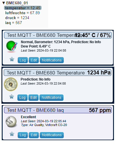

I sent the following MQTT messages and saw devices like:
Sans titre.png (35.74 KiB) Viewed 2583 times
Are you sure you sure:
1) you have exactly the same settings as me?
2) MQTT is properlly updated?
Concerning changes to code, this is not mandatory anymore, since last changes. However, should you really want to do this, I can give you the lines to add.

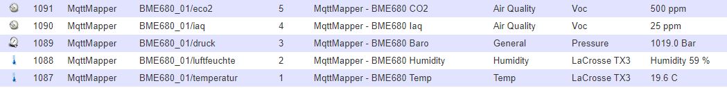

Yes Mqtt explorer is responding well. I have changed the the json file again and get this result. Barometer does't appear in the Domoticz Gui

If you prefer having 4 different devices (temperature, humidity, pressure and voc), then load last version (1.0.26) of plugin and use the following configuration file:
	"BME680 Temp": {
		"topic": "BME680_01/temperatur",
		"type": "80", "subtype": "5",
		"mapping": {"item": ""}
	"BME680 Humidity": {
		"type": "81", "subtype": "1",
		"mapping": {"item": ""},
		"initial" : {"nvalue":0, "svalue": "0"}
	"BME680 Baro": {
		"topic": "BME680_01/druck",
		"type": "243", "subtype": "26",
		"mapping": {"item": "~*;~0"},
		"initial" : {"svalue": "0;0"}
	"BME680 Iaq": {
		"topic": "BME680_01/iaq",
		"type": "249", "subtype":"1",
		"mapping":{"item":""}
FYI, humidity was not updated due to the fact that standalone humidity sensor need an integer value in nValue while other sensors accept float values in sValue. And your device returns a float value, not compatible with humidity sensor. I made a change in 1.0.26 to round float value in this case.

I can report improvements on the latest version. Thanks a lot for your initiativ. I prefer to have different devices from this topic because I need the sensor accuracy and error value as well. I had no time to test it but I will come back on this. Pls. continue your work because the missing interface between the mqtt broker and Domoticz is a big disatvantage.
