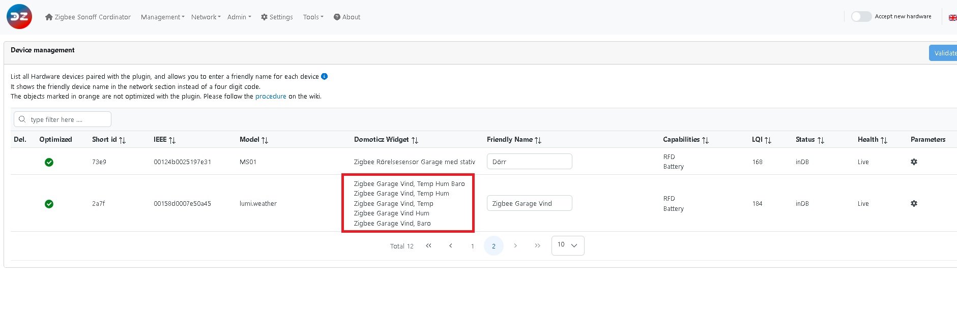

I don't understand how to transfer the log, When i press "Replace" on the old device and choose the new widget created by Zigbee for Domoticz. I lost the widget connection in zigbee for domoticz.
The Domoticz widgets in the red square disappears
Plugin: 7.1.009 [4.229]
Firmware: UNK - 6.10.3.0 build 297

When i Press replace I got this message in the log
2024-03-02 17:21:23.826 Status: Zigbee Sonoff Cordinator: onDeviceRemoved - removing End Device

My method works with rfcom 433mhz and OpenZwave so I'm thinking the same tactics should have worked.
I even tried creating a fake temp sensor and moved the log to it and then transferred it to a Zigbeefordomoticz temp sensor.
Unfortunately, the intercession between domoticz and zigbee for domoticz disappears. Everything inside the red box disappears.

Could perhaps be an issue when multiple Domoticz devices are attached to the same zigbee node?
Re: Zigbee for Domoticz, Transfer old Log from old device to new device, Error
I'm not sure I understood what you want to do, but from what you described, indeed the plugin doesn't handle that, as it is not notified about this.

I have some zigbee sensors connected true xaomi gateway. I want to move/transfer them to the new zigbee for domoticz network.
My problem is that I also want to save the old sensorlog in domoticz when i migrate to the new zigbee for domoticz network.

That is possible with the replace function if the old and the new domoticz devices (eg temperature, energy counter etc) are of the same type. That is not always the case as Hardware gateways interpret combined devices sometimes differently.

It is not hardware protocol but the Domoticz device has to be the same. You cannot merge a old temp/hum device into a new temp device.
You also cannot merge and old electric usage device into a electric instant and usage device. So check both Domoticz devices in the device list and they have to be the same.
