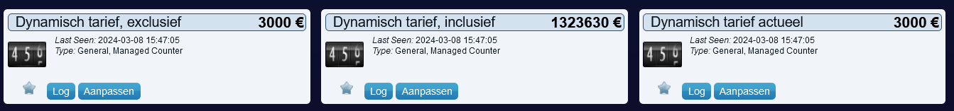

willemd wrote: Wednesday 06 March 2024 10:58 Here is my latest dzvents script to load the prices onto a managed counter for later display in domoticz and dashticz.
@willemd,
Thanks for sharing the script I was looking for! However, I am amazed at the script's output. I created a user variable VAT (integer 21) and a user variable energy tax (string 13.2).
I know the option to set a divisor. But I don't understand the result of the 2 counters on the right?
Thanks in advance.
willemd
Posts: 737
Domoticz version: 2024.1
Re: How to retrieve ENTSOE electrical consumption of France?
Post by willemd »

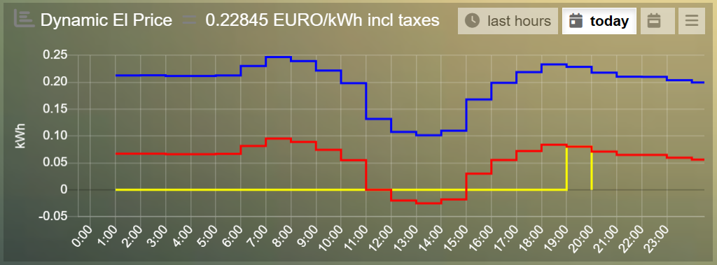

You need to adapt the counter divider on the managed counter to 100000.
The first counter is excluding tax (red line below), the second is including tax(blue line below). Both show the full list of available prices.
The third counter only shows the tariff of the current hour and is used as a sort of arrow in a dashtic graph to highlight the current hour, see the yellow line below in the graph.
Here is also the graph definition
blocks['graph_ElPrice'] = {
    title: 'Dynamic El Price',
    width:12,
    height: '260px',
    graph: 'line',
    steppedLine: ['before','before','before'],
    buttonsText: ['last hours','today',''],
    devices: [177,179,184],
    beginAtZero: true,
    customHeader: 'devices[184].Data+" incl taxes"',
    range: 'today',
    legend: false
Screenshot 2024-03-08 192406.png (188.11 KiB) Viewed 399 times
