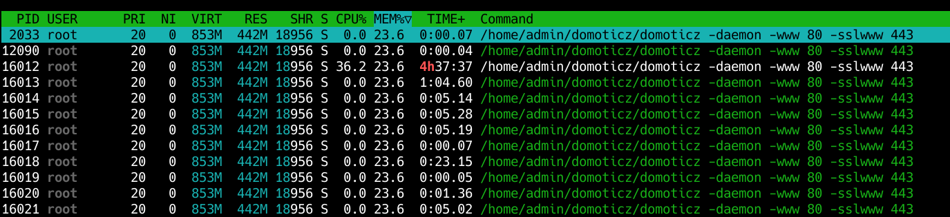

Good point about the system mem. However I am certain it is the domoticz process, since restarting solves the issue. For example. This is the current system mem This is the domoticz mem usage: After: sudo service domoticz.sh restart
Is there a way to quickly determine the memory usage of the Domoticz subprocesses?

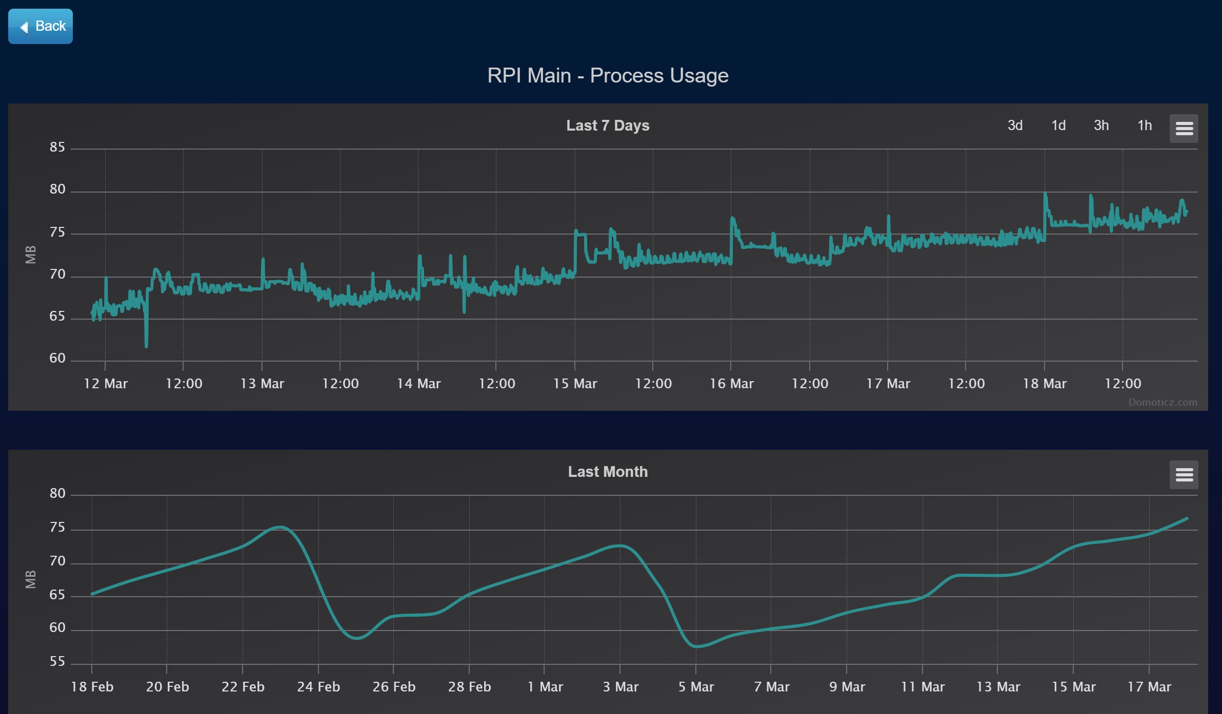

Perhaps someone knows a better way to debug this but I would start with disabling the degreeday script for a day and see if the memory leak stays.
Do you restart only the Domoticz process or the complete system? You have a device called "process usage", please check that to be sure it is Domoticz (probably is)

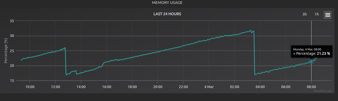

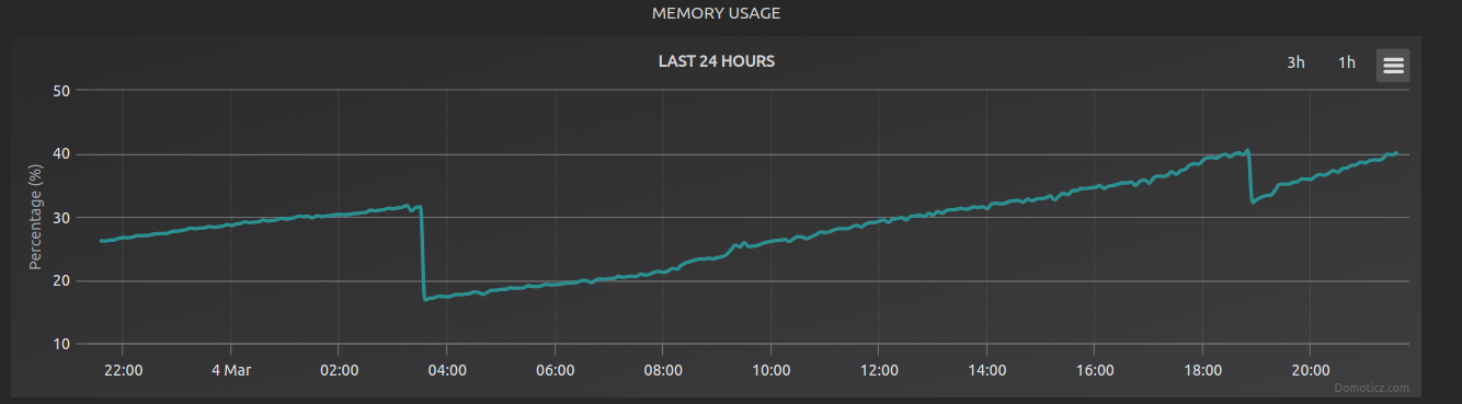

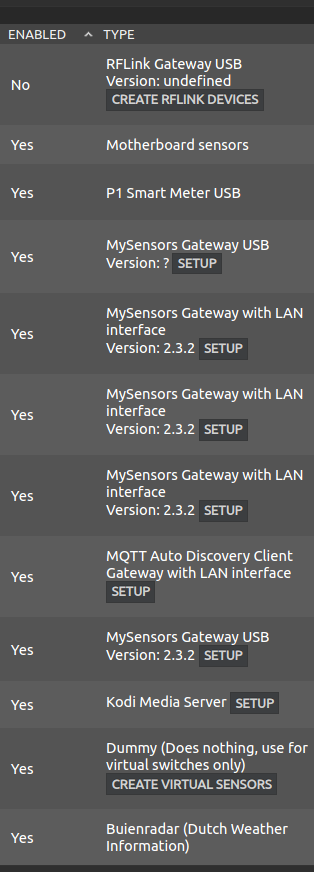

I did some testing last weeks. The leak correlates with enabled hardware, not with any script. More enabled hardware = more memory leaking away.
Herewith a image. Yesterday evening I disabled most of the hardware. At 3:30 the daily restart occurs. At 9:00 I disabled all hardware, except the PI-sensors. 11:30 I started to enabled hardware again.
Since I have in total about 800 devices I need to restart demoticz daily as after a day of two the OOM-killers kills the Domoticz process.
