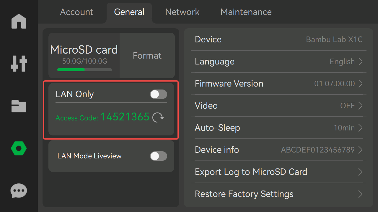

I also made a succesfull connection using MQTT explorer by using
- TLS on
- IP adress of your X1 printer
- Port 8883 with
- Username "bblp"
- Password is the LAN access code that can be found on the printer under "Settings" and then the "general" tab
