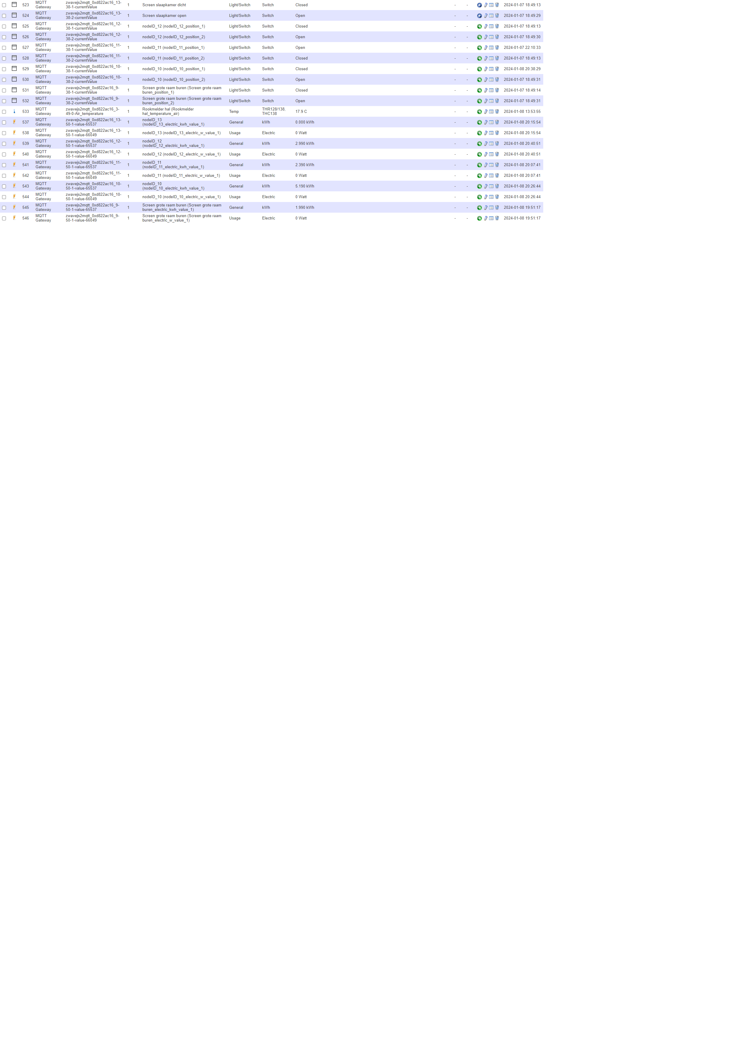

I read your comment, but since there was no need to keep the logging of the old Zwave devices (as they are all switches), there was no need to use the Replace function in my opinion. Since i deleted the old Zwave devicelike said in the wiki, im not able to Replace them at this moment.
I did exactly what was written in the wiki Migration page and i got to 90%. I got all the Zwave devices in the Devices tab, but when i add the Device (lets say a light switch), its nowhere to be found. I can switch the light via the Devices tab, its just nowhere to be found outside of the devices tab.
My Fibaro Roller Shutters 3 show alot of entries in the Devices tab, but noone of them to control the screens. Only overcurrent status, current values, position 1, position 2 etc etc.
I will see if removing and adding the devices works. No idea what to do.

That could be another issue.
Go to Setup->Users, check that your user account does not have any specific devices set to be displayed/used

When in the User menu, to the right it has the SET DEVICE button. 22 devices were not selected. Once i selected them all, the device were shown.
Thanks, this made my day!
