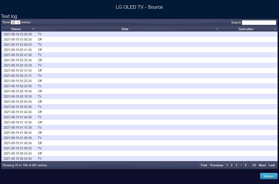

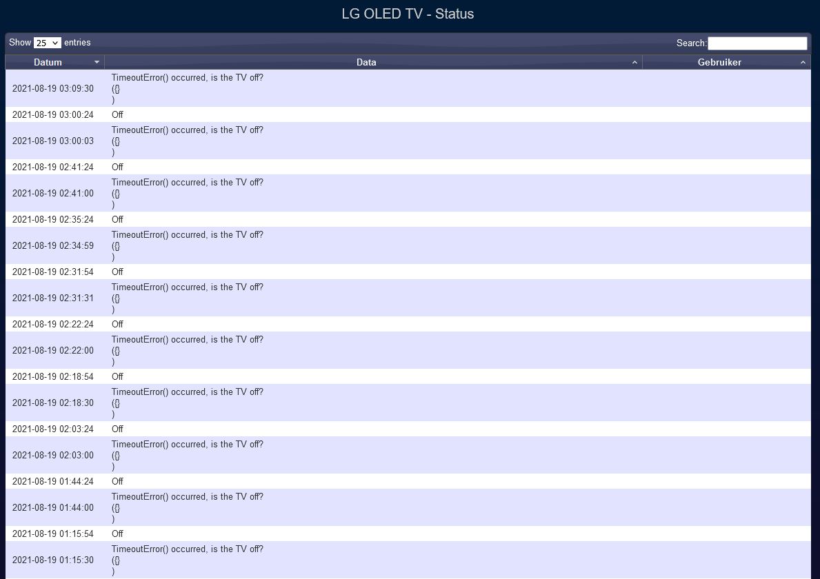

I have the new LG OLED 2021
The plugin works great, thanks for all the effort!
I have only 1 problem with the device status when the TV is off
1. The status device shows "TimeoutError() occurred, is the TV off?({})"
2. The Source device then sets the source to "TV"
Can someone help ?
The below screenshots is the behaviour of the devices at night, when the TV is off
TV Source.JPG (103.1 KiB) Viewed 27442 times
TV Status.JPG (105.02 KiB) Viewed 27442 times

I get this in my logg, how to fix this?
2021-09-25 19:30:46.037 LG TV: (LG TV) Info: TimeoutError() occurred, is the TV off?
2021-09-25 19:30:46.038 (LGTV) Updating device from 0:'Off' to have values 1:'TimeoutError() occurred, is the TV off?
2021-09-25 19:30:46.038 (TimeoutError() occurred, is the TV off?
2021-09-25 19:30:46.038 )'.
2021-09-25 19:30:46.067 LG TV: (LG TV) Update 1:'TimeoutError() occurred, is the TV off?
2021-09-25 19:30:46.067 (TimeoutError() occurred, is the TV off?
2021-09-25 19:30:46.067 )' (LGTV)
2021-09-25 19:30:46.067 (LG TV - Source) Updating device from 0:'0' to have values 1:'10'.
2021-09-25 19:30:46.080 LG TV: (LG TV) Update 1:'10' (LG TV - Source)
2021-09-25 19:30:52.041 LG TV: (LG TV) Pushing 'onHeartbeatCallback' on to queue
2021-09-25 19:30:52.091 (LG TV) Processing 'onHeartbeatCallback' message
2021-09-25 19:30:52.091 LG TV: (LG TV) Calling message handler 'onHeartbeat'.
2021-09-25 19:30:54.856 LG TV: (LG TV) Status TV: off
2021-09-25 19:30:54.857 (LGTV) Updating device from 1:'TimeoutError() occurred, is the TV off?
2021-09-25 19:30:54.857 (TimeoutError() occurred, is the TV off?
2021-09-25 19:30:54.857 )' to have values 0:'Off'.
2021-09-25 19:30:54.878 LG TV: (LG TV) Update 0:'Off' (LGTV)
2021-09-25 19:30:54.878 (LG TV - Source) Updating device from 1:'10' to have values 0:'0'.
2021-09-25 19:30:54.892 LG TV: (LG TV) Update 0:'0' (LG TV - Source)
