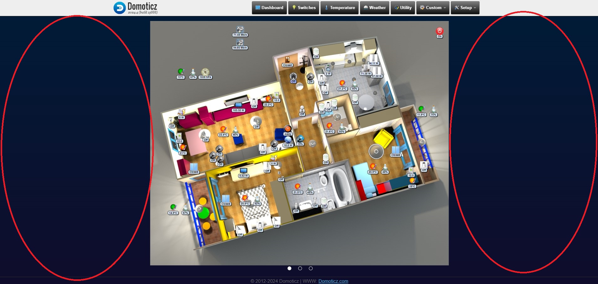

Hello everyone, I am new to the forum but not to domoticz. I have been using it for years, first on a rapsberry pi and now on a mini pc with Ubuntu, zigbee, mqtt, netatmo...
The point is that I am delighted with it, but now I find myself with an issue that I don't know how to solve. Until now I had a floorplan with the sensors, switches... placed in it and everything worked ok. But now I have decided to give it a facelift and have changed the floorplan to 3D. The point is that the uploaded plan does not occupy the entire screen, but rather there is a lot of "wasted" space as you can see in the image (red circles). I don't know if the plane can be enlarged or it has to stay like this. I already have the rooms configured to zoom when clicking on them, but I would like the general plan to look larger.
Thank you all.
Thank you all.

I think you have to create a new floorplan image that fits your screen better.

Thanks,
I have created another plan with other proportions and I have increased the work area and it looks bigger and better.
