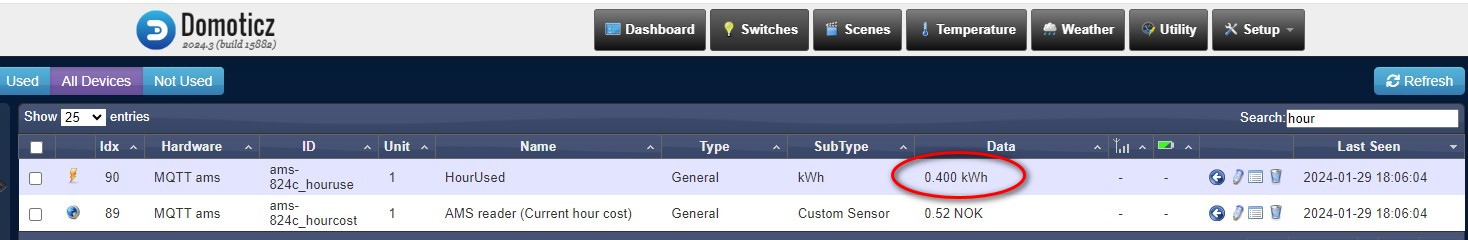

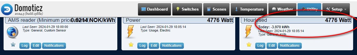

The actual sensor is a power probe, reporting power consumption in my home. I use home assistant autodiscovery in Domoticz to get the sensors into Domoticz. The problem is with the Utility widget showing a different value from that in the device view (se pictures).
Can anyone explain what is going on, and adwise me to get the device value into the widget?

What you see in the device list is the total kWh generated or produced while this device is being monitored.
Check to log or report page of that device to see more information.

What you see in Hardware tab is probably total of (usage - return, here 0.400 kWh)
In addition to that, Domoticz computes some daily values, saving midnight's values and making difference with current ones.
What you see in widget is probably instantaneous (CONS - PROD, here 4776 Watt) and daily (usage - return, here -3.970 kWh)
The negative part (-3.970 kWh) could mean 2 things: you do produce energy (with solar panel for example, and have produced more than drain from grid), or USAGE and/or RETURN values are not correct (as this is the sum of what meter has seen since it's installed).

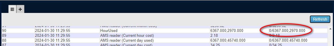

In the value field for in the events view I can only see two values (picture)
Maybe the home assistant auto discovery is not the best thing to do here. Seems to be some mismatch between the received mqtt and what Domoticz is expecting.

For a General kWh device you are using has two values so this seems correct.
POWER = current power (W)
ENERGY = Integer, total cumulative energy in Watt-hours (Wh)
https://www.domoticz.com/wiki/Domoticz_ ... counter.29
FlyingDomoticz is referring to a P1 smart meter Device that has indeed more values, but you are not using that.
