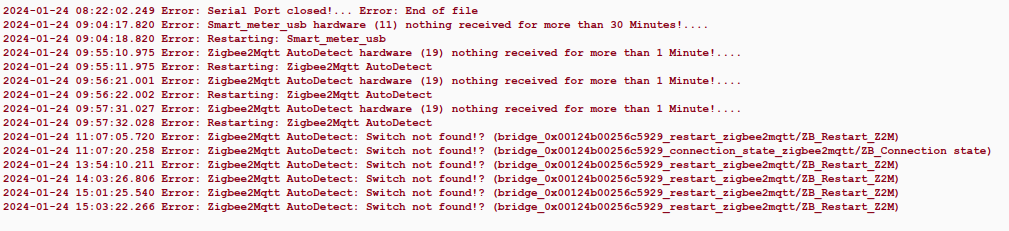

- domoticz log
- Screenshot_log.png (125.88 KiB) Viewed 1792 times

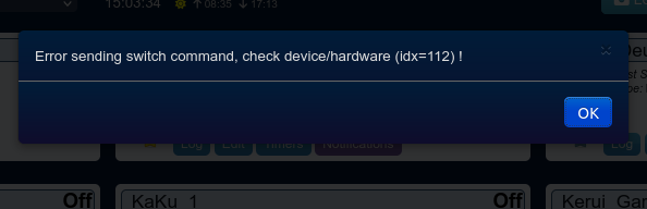

- Error generated
- Screeshot_error_restart_z2m.png (17.55 KiB) Viewed 1792 times

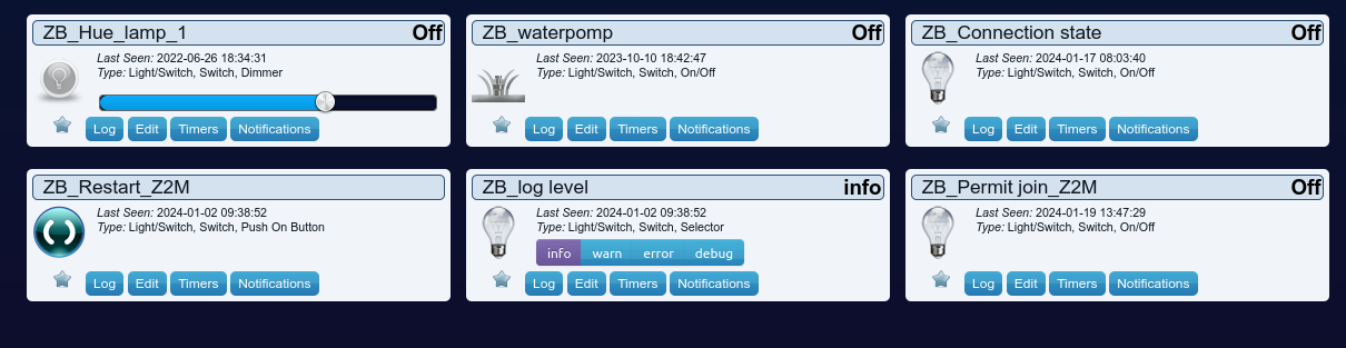

- Part off switches discovered.
- Screenshot_zigbee_switches.png (61.08 KiB) Viewed 1792 times

I mean the switch in domoticz's switches tap (z2m-restart_z2m). This is auto created by the z2m auto detected (from the Sonof-dongle). You can push the symbol and than you get the error. In Home Assistant you get the same switch and there it works out-off the box. The ZB_waterpomp is also auto created from a Sonof-wall-socket build-in switch, but works oke.
I gues it has something to do with the device-class of these these things.
