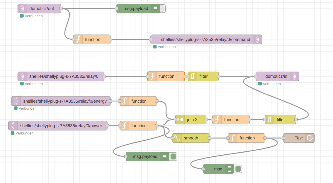

For a shelly Plug S, the NR integration looks as simple as the pic below. All it really does, is 'translating' MQTT from Shelly to MQTT for Domoticz. The devices I create manually (one Switch and one Smart Meter).
For shelly 1 it's even easier, because it doesn't measure power / energy.
If you want to give it a go, I'd be happy to post the flow here, so you can try yourself.

sure thing, here you go
Please note, the bottom portion that ends in the node labelled 'test' is an integration to InfluxDB to record energy consumption.
If you don't have that, you can just delete that part.
It goes without saying trhat you will need to adapt the flow to your system (Shelly ID, broker connection, etc)

As for the architecture approach:
I used to have one generic flow per device typ (shelly). This was accomplished by setting the topic prefix in the shelly device to the corresponding Domoticz IDX (in MQTT settings of the shelly device).
So it was (example): shellies/IDX/relay/0/command. This way I could route dynamically and had just one flow for each type.
However, it makes sense to add automation tasks directly in node red (example: swith a light from a motion sensor).
This is why I split it up into flows per single device, since I have different automations for almost every device.
I generally am moving all logic and automation toward NR, so I will be able to migrate from Domoticz to a different system (currently testing)

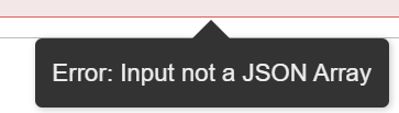

While trying to copy paste your examples I get:
I first thought this code needs to go somewhere in the Tasmota rules part, however based on what I learned in a different forum topic it could just as well be a one-off trick in mqtt-explorer indeed to 'teach' domoticz the device. Am i right ?

You are right. It will "teach" domoticz to discover your Tasmota v11+ device
