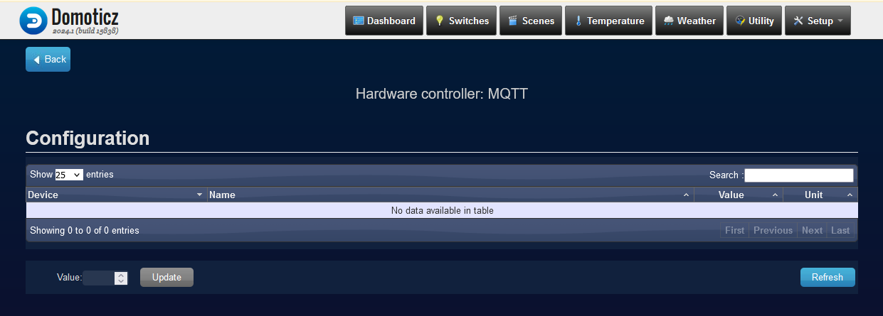

The problem is that i do not see any devices appearing in Domoticz when i open the MQTT device in domoticz.

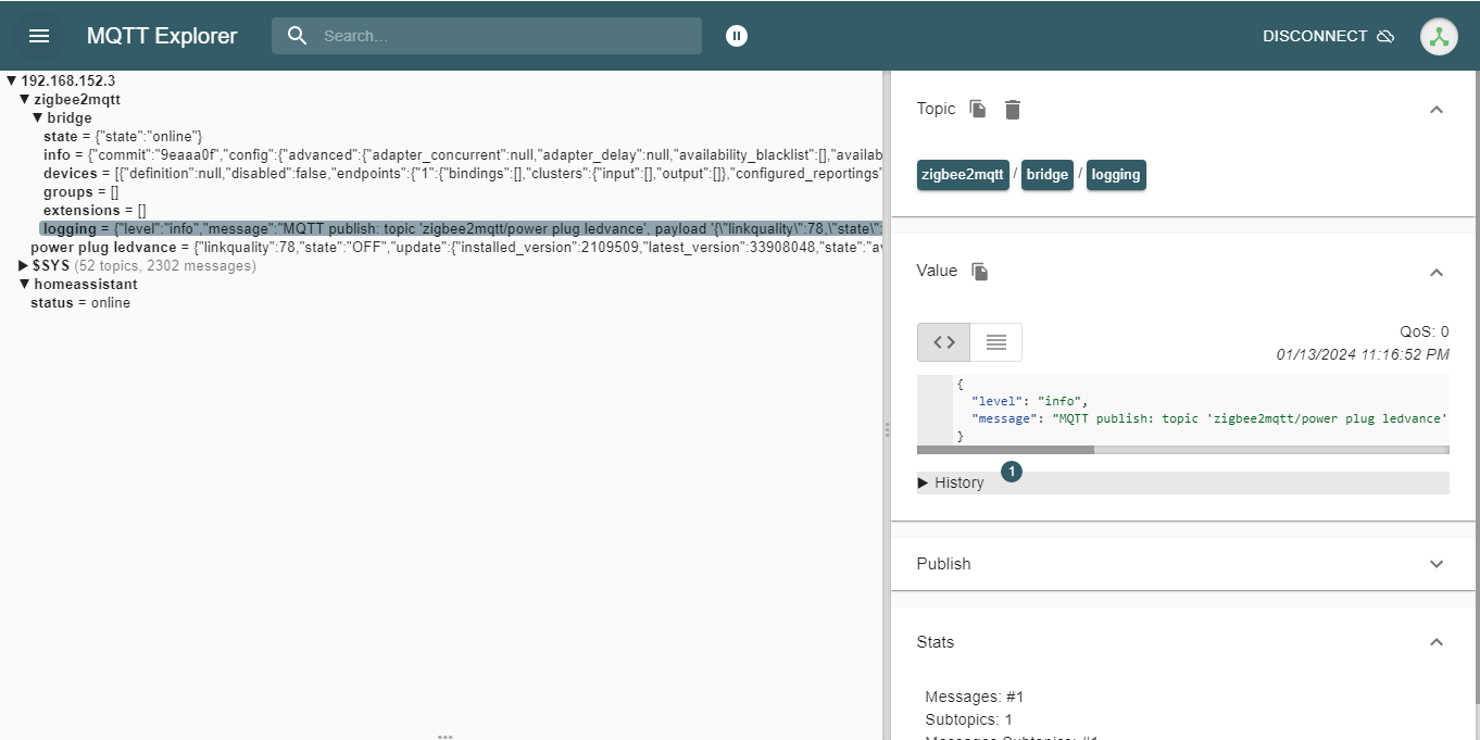

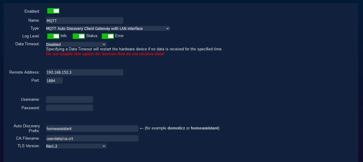

i am attaching my mqtt device config in domoticz, the empty device list and mqtt explorer view
here is what i see in mosquitto when i subscribe to all topics using mosquitto_sub.
First two lines pops up when i restart MQTT device in domotics by clicking update, second two lines appear when i flip the switch on Zigbee device.

Looks like the problem is in Zigbee2MQTT.
There should be devices listed in mqtt homeassistant folder. So it seems your configuration in Zigbee2MQTT is not correct. Check the logs of Zigbee2MQTT.
Second. The new devices from Zigbee2MQTT will not show in the Domoticz hardware gateway setup button configuration list but in the Domoticz device list, menu Setup- Devices.

https://www.domoticz.com/wiki/Zigbee2MQ ... todiscover
Zigbee22MQTT settings:
In your Zigbee2MQTT configuration.yaml set homeassistant: true (link) , nano /opt/zigbee2mqtt/data/configuration.yaml or use the User interface:
Eugene
- Posts: 43
- Joined: Wednesday 21 December 2016 19:30
Re: Domoticz to Mosquitto communication
waltervl, thanks a lot! this was my problem, now discovery works!
