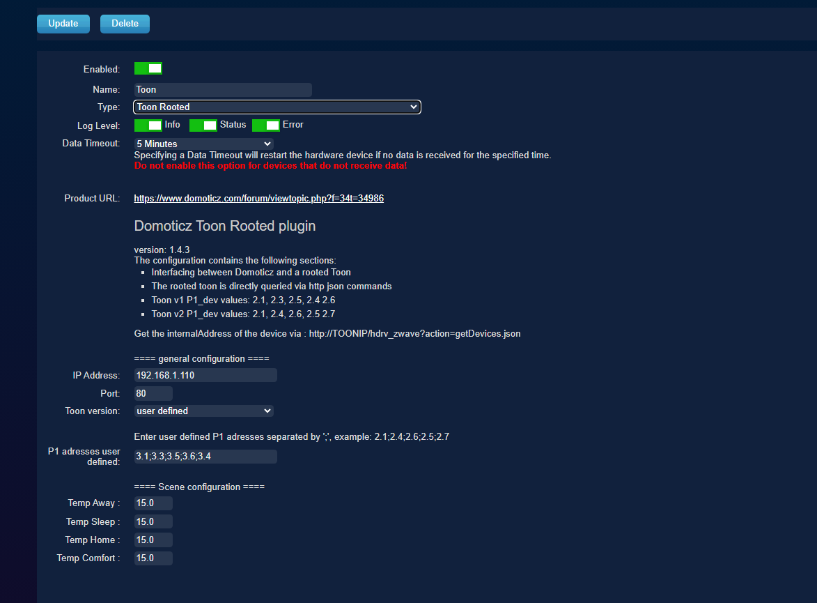

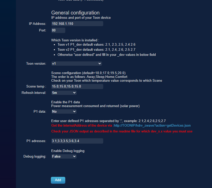

I have downladed the latest my zwave devices start with 3.1 etc., when I actiovtae the plugun ik get temp etc, i do not get the P1 Data, yes Opentherm is activated.
I always used the old plugin but after updating domoticzz i switched to to latest version of rooted. see attached.
below my output:
{"dev_settings_device": {"uuid": "5e572aad-82d5-4d7b-9552-c81b6bb46b7e", "name": "settings_device", "internalAddress": "settings_device", "type": "settings_device"}, "dev_3": {"uuid": "49c9f652-ee80-4f8b-a300-a73e5649941e", "name": "HAE_METER_v2", "internalAddress": "3", "type": "HAE_METER_v2", "supportsCrc": "1", "ccList": "22 3c 3d 3e 56 60 70 72 7a 86 8b 73", "supportedCC": "22 3c 3d 3e 56 60 70 72 7a 86 8b 73", "nodeFlags": [], "IsConnected": "1", "HealthValue": "10", "DeviceName": "HAE_METER_v2", "CurrentSensorStatus": "UNKNOWN"}, "dev_3.1": {"uuid": "ae32a545-7eea-467f-bb43-dc3576a72556", "name": "HAE_METER_v2_1", "internalAddress": "3.1", "type": "HAE_METER_v2_1", "supportsCrc": "0", "ccList": "3c 3d 3e 72 86", "supportedCC": "3c 3d 3e 72 86", "nodeFlags": [], "CurrentSensorStatus": "OPERATIONAL", "CurrentGasFlow": "163.00", "CurrentGasQuantity": "1672125.00", "DeviceName": "HAE_METER_v2_1"}, "dev_3.2": {"uuid": "80bad6e0-681a-4193-aebc-0139ed974309", "name": "HAE_METER_v2_2", "internalAddress": "3.2", "type": "HAE_METER_v2_2", "supportsCrc": "0", "ccList": "3c 3d 3e 72 86", "supportedCC": "3c 3d 3e 72 86", "nodeFlags": [], "CurrentSensorStatus": "UNKNOWN", "DeviceName": "HAE_METER_v2_2", "CurrentElectricityFlow": "NaN", "CurrentElectricityQuantity": "NaN"}, "dev_3.3": {"uuid": "65d75acc-6ed8-4e8a-8521-505b94d331bd", "name": "HAE_METER_v2_3", "internalAddress": "3.3", "type": "HAE_METER_v2_3", "supportsCrc": "0", "ccList": "3c 3d 3e 72 86", "supportedCC": "3c 3d 3e 72 86", "nodeFlags": [], "CurrentSensorStatus": "OPERATIONAL", "DeviceName": "HAE_METER_v2_3", "CurrentElectricityFlow": "214.00", "CurrentElectricityQuantity": "6728309.00"}, "dev_3.4": {"uuid": "0f7ca805-1a6e-4025-8c00-83f1ec0dd4bc", "name": "HAE_METER_v2_4", "internalAddress": "3.4", "type": "HAE_METER_v2_4", "supportsCrc": "0", "ccList": "3c 3d 3e 72 86", "supportedCC": "3c 3d 3e 72 86", "nodeFlags": [], "CurrentSensorStatus": "UNKNOWN", "DeviceName": "HAE_METER_v2_4", "CurrentElectricityFlow": "0.00", "CurrentElectricityQuantity": "8381536.00"}, "dev_3.5": {"uuid": "1c7ac58f-bfb1-4101-a88b-53bab7643ee0", "name": "HAE_METER_v2_5", "internalAddress": "3.5", "type": "HAE_METER_v2_5", "supportsCrc": "0", "ccList": "3c 3d 3e 72 86", "supportedCC": "3c 3d 3e 72 86", "nodeFlags": [], "CurrentSensorStatus": "UNKNOWN", "DeviceName": "HAE_METER_v2_5", "CurrentElectricityFlow": "0.00", "CurrentElectricityQuantity": "6573979.00"}, "dev_3.6": {"uuid": "8b59596d-f5ec-47e0-9e3d-92384ed0159d", "name": "HAE_METER_v2_6", "internalAddress": "3.6", "type": "HAE_METER_v2_6", "supportsCrc": "0", "ccList": "3c 3d 3e 72 86", "supportedCC": "3c 3d 3e 72 86", "nodeFlags": [], "CurrentSensorStatus": "UNKNOWN", "DeviceName": "HAE_METER_v2_6", "CurrentElectricityFlow": "0.00", "CurrentElectricityQuantity": "3823170.00"}}
Took some time, had issues with my account but back in.
below my output:

After some digging is found:
GAS "dev_3.1": "CurrentGasFlow": "0.00", "CurrentGasQuantity": "1954707.00", "DeviceName": "HAE_METER_v2_1"},
elec_delivered_normal dev_3.3": "CurrentElectricityFlow": "0.00", "CurrentElectricityQuantity": "7600469.00"},
elec_delivered_low dev_3.5": "CurrentElectricityFlow": "0.00", "CurrentElectricityQuantity": "7348754.00"},
elec_received_normal dev_3.4": "CurrentElectricityFlow": "3212.00", "CurrentElectricityQuantity": "8732525.00"},
elec_received_low dev_3.6": "CurrentElectricityFlow": "NaN", "CurrentElectricityQuantity": "NaN"}}
so my custom squence should be:
3.1;3.3;3.5;3.4;3.6
025-03-21 14:26:36.184 Error: Toon: Traceback (most recent call last):
2025-03-21 14:26:36.184 Error: Toon: File "/opt/domoticz/userdata/plugins/domoticz_toon-main/plugin.py", line 660, in onMessage
2025-03-21 14:26:36.184 Error: Toon: _plugin.onMessage(Connection, Data)
2025-03-21 14:26:36.184 Error: Toon: File "/opt/domoticz/userdata/plugins/domoticz_toon-main/plugin.py", line 545, in onMessage
2025-03-21 14:26:36.184 Error: Toon: self.onMessageZwaveInfo(Connection, Response)
2025-03-21 14:26:36.184 Error: Toon: File "/opt/domoticz/userdata/plugins/domoticz_toon-main/plugin.py", line 490, in onMessageZwaveInfo
2025-03-21 14:26:36.184 Error: Toon: zwaveReceivedQ=str(int(float(zwaveReceivedNtQ))+int(float(zwaveReceivedLtQ)))
2025-03-21 14:26:36.184 Error: Toon: ValueError: cannot convert float NaN to integer
But still getting errors
the crash is caused by: Toon: ValueError: cannot convert float NaN to integer
is there any fix?
Hemants
3.1;3.3;3.5;3.4;3.6
is there any fix?
Hemants
